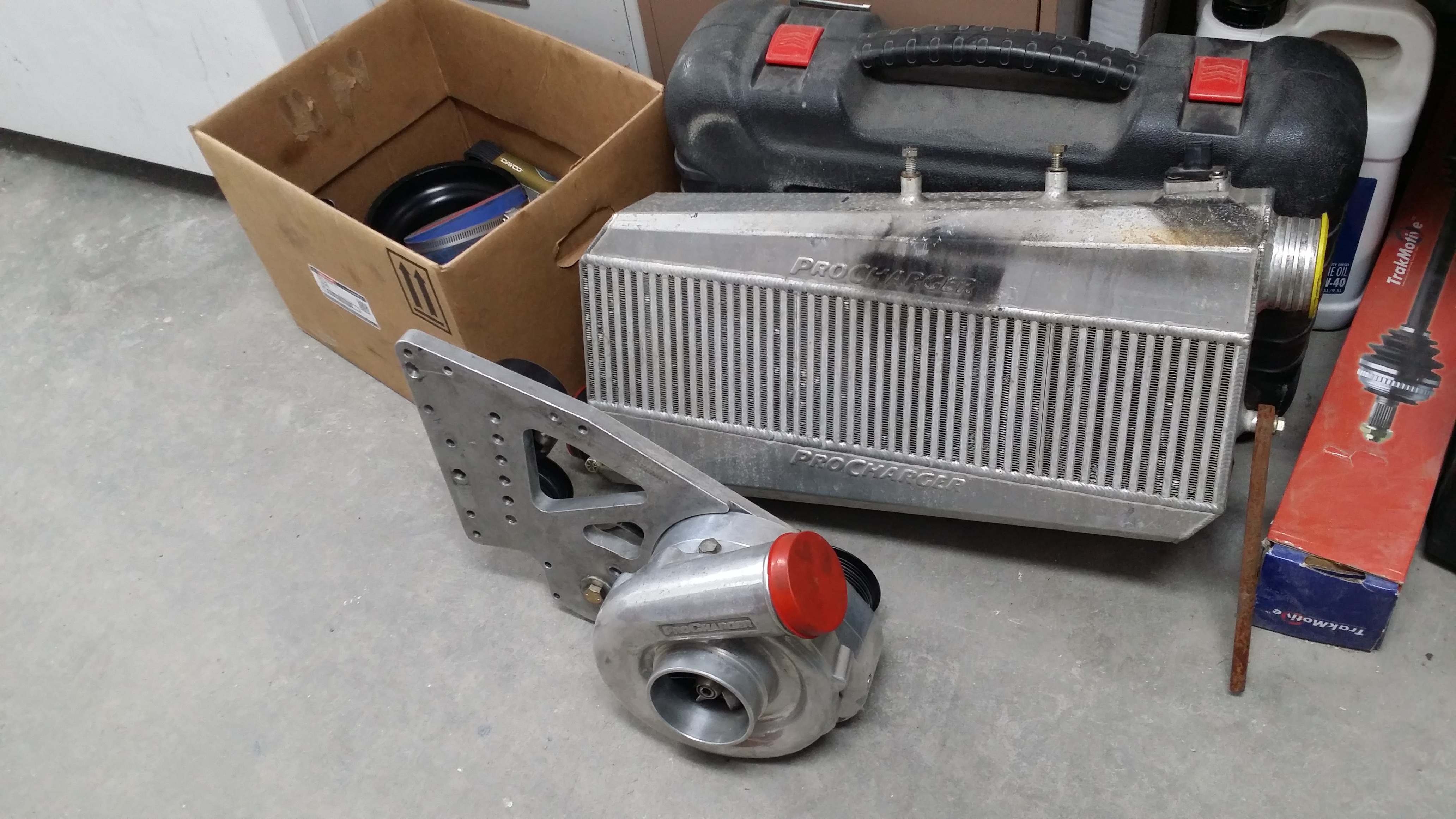

here are some of the pics from my build thread , keep in mind its in a two door but in all the areas that matter the fitment is the same , also if you use a string to check length my driver side is only inches longer , i tried to get as close to equal length as possible

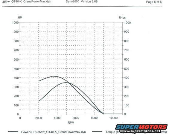

I recommend Desktop Dyno or another good engine simulation program. A good program can save you money and teach you much! It is nice to know what you are building before you build it. This is my last blown V8 in Desktop Dyno Power at the flywheel,10lbs of boost 351W:

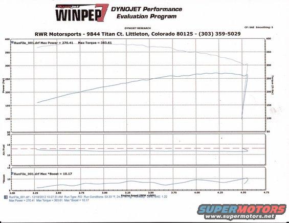

Same engine, real world power to the ground 270HP & 383ftlbs of Torque:

Boost is for the most part way out of most people's price range. Let along trying to find either a powerdyne or EE M90 kit are few and far between. The only other thing would be to scratch build your own turbo or supercharger kit, and that too isn't very easy.
As for exhaust, yup. Had a shop make a system on mine. On the dyno I made around 10 hp and about the same in torque
I believe if you compare the cost per horse, adding 6lbs of boost to a stock engine is less expensive than most modifications. I am talking DIY stuff and not high dollar kits.
Price-out a cam, heads, headers, and exhaust. Those would be the minimum items to approach similar gains from 6lbs. of boost.
Once again, there were 2 supercharger kits made ever of a 2nd gen 5L, and no turbo kits. I've made my supercharger set up, and have another member that lives close to me that made his own turbo kit. That adds up fast, no to mention having to work out bugs on something most people have never done before

include how many hours of time this is going to take to make the intake and blower you bought work. if thats from a f150, it aint going to be a direct bolt on.
Yes because installing heads, camshaft, headers and exhaust is going to be a snap?
I have heard about the stupid amount of time it takes to install headers. There is nothing that special about setting up a blower like you did and there are many more than a couple people here who have done so. Sorry, just not that special or hard and it is within reach of many. I won't need all the help you did.
I may recast the awesome intake to blower manifold to make it available for others. It will bolt right on! That gives me a head start over the box you have................
You got a nice truck but how much of it did you really do anyway to be telling me how mine is going to go? Again this will be my fourth DIY blower set-up with tuning.
My momma told me I was special, but I found out otherwise, nothing special about this and doable for many!
