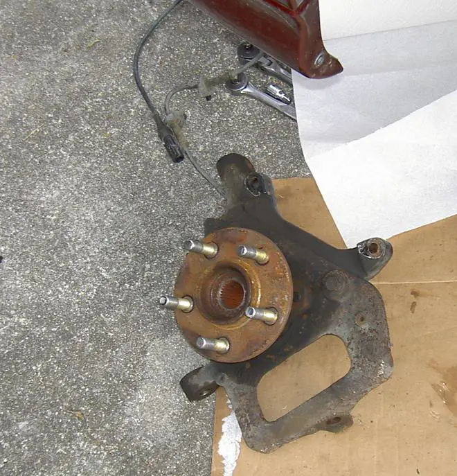

The 0.625" size will be fine versus the 0.0627", I'm sure there is a range which will work okay. You have to have 1/2" worth of threads to engage the nuts, which is usually about five for typical 1/2"-20 studs. ARP studs would be the best(strongest) if they have them in the needed size, I got mine from Summit I think. They were about an inch too long and I had my machine shop cut and install them.

Good to know. I'll order the 3" long 0.625" knurl studs and have them turned down. I imagine you have to be careful not to heat them much when machining so as to avoid ruining ARP's heat treatment. I also want to clarify, if the thread pitch is 20 threads per inch, you need 10 full turns to reach 1/2" of thread engagement. Five turns would only yield a quarter inch and would not be enough.

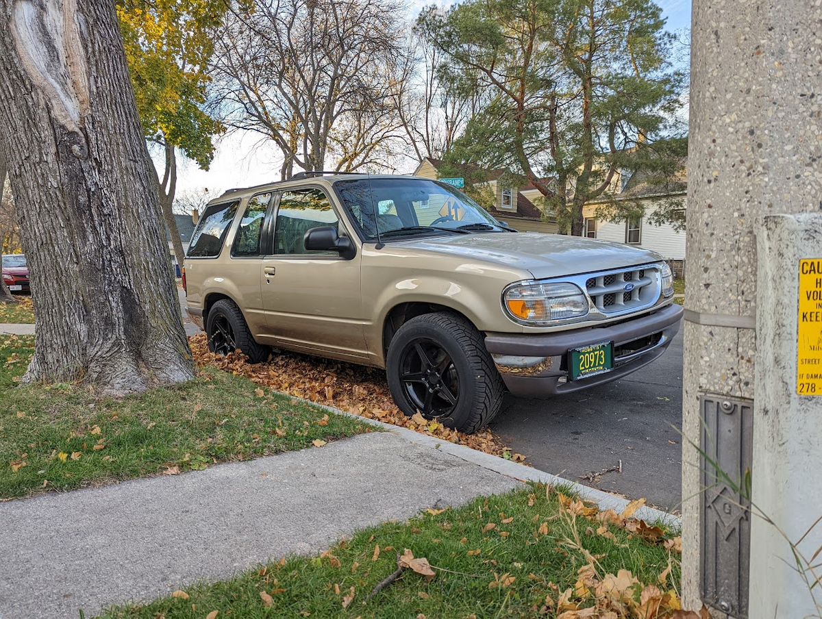

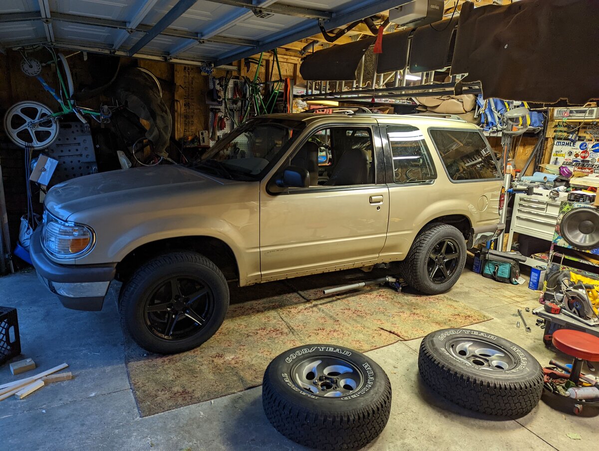

Figured I should follow up here for those not following my suspension upgrade thread. Almost finished my setup, currently down 2" in the rear and about 2 1/4" in the front. Any lower and I don't think I could have gotten a proper alignment -- I had the camber adjusters at the max and my mechanic said camber was just in spec.
Also ended up with 11mm spacers behind my 17x9ET24 rims with 275/55 tires on them. I want to get the paint cleaned and polished then put my flares back on, but the poke now isn't much.
