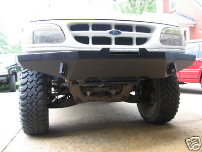

I want to incorporate a push bar into a winch bumper which of course is going to have to be fabricated. but I do know of a bumper design id like to start off with. I found this on google which brought me to an etsy page a few years back for a ranger bumper. pictured here:
I love the way this looks. Now here is a picture of the push bar I currently have on my sploder:
Now if I could find someone, id like them to bring that brush guard center support forward to act as the push bar. Id be able to keep my lightbar, add a winch, and keep my fog lights all in one. Let me know what you think.
Now the guy on etsy used to sell the CAD files for this bumper but it appears the listing for this particular bumper is no longer up. Ill have to reach out again and see if he is still active.

Honestly Leaning toward this idea. Most pre-builts are close but not exactly what I want. and the ones that are closer are harder to adapt. It will be interesting doing this with cardboard, and im not the best artist, but hey this may be fun.
I got a friend who would be willing to help/teach me to weld so no worries there. Ill try and share some markups when I save enough cardboard
