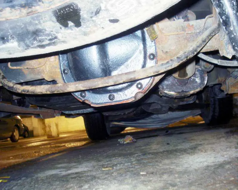

Well thanks everyone. I got it out and got 'er all done. I'll have a relief pic later.
Featuring a platinum differential cover, black enamel bolts and a gold ID tag.

Well done! How bad of a shape were the bearings?
They weren't bad at all. The axle was real smooth too. This was more of a preventative. I knew the fluid could use a change and I figured if I'm in there why not do the bearings. This should complete the rear end for the life of the vehicle. It already has 220k km and if it makes it to 320k I'm happy.
