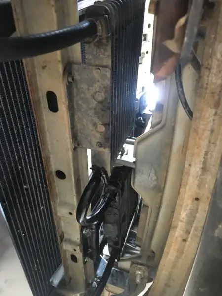

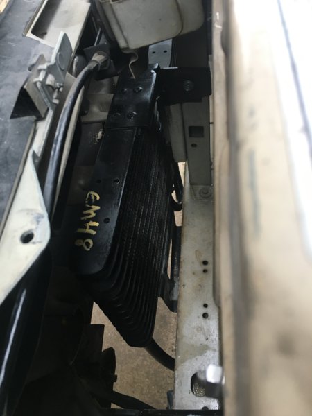

Well my cooler idea got put on hold for awhile after my last fiasco. But ended up at the yard this morning and found a cooler off of a Sport Trac so I snagged it.

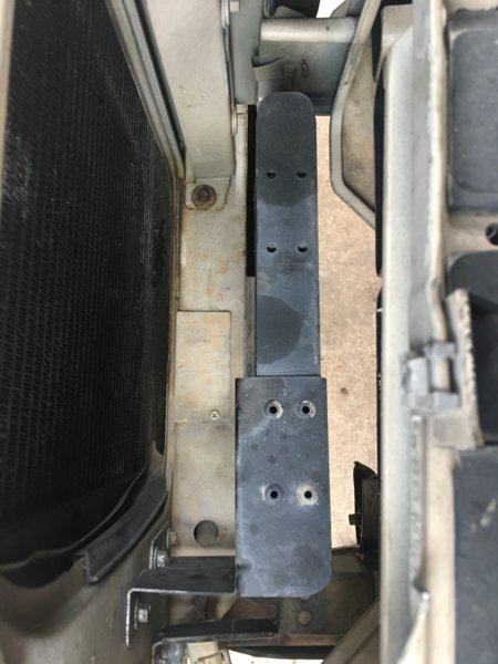

Now I just have 2 OEM coolers and bypassed the radiator. The mounting bracket is a little different so it sits up about 2 inches higher so it doesn’t have the symmetrical look I was hoping for.
