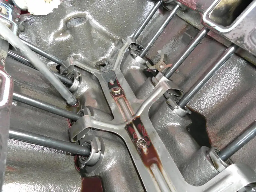

the lower isnt so much as a pain to remove, but just takes a lot of time. the only other thing you have to do is remove the lifter retainer or as i call it spider (you'll see what i mean if you do it), and the "dog bone" as i call it as well. i also believe the rockers are torqued down as well, and dont really need adjusting when you put it all back together
Spider :)
