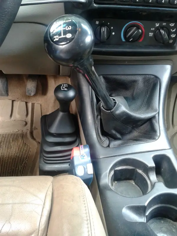

Just got done swapping a 4406 and a M5OD into my 97 mountaineer and the results are incredible!! I got 21 MPG on my last fillip and the steering has a much lighter feel to it along with much faster acceleration!

I was getting about 15 to 16 miles per gallon, I actually did the manual swap first, aside from quicker exceleration the mileage did not change, that piece of shi* all wheel drive transfer case was sucking the life out of the engine, not to mention its lack of a real low range!! This thing will now rip stumps out of the ground in low 4!

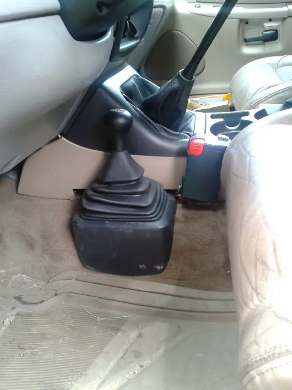

It all basically bolted right up, the only thing I had to modify was the gas tank bracket and cut a hole in the floor for the 4 wheel drive shifter.
But you can really feel the difference, I cannot believe how much power that all wheel drive case robs from the engine
The shifter boot for the 4 wheel drive shifter is off of an f 150, and you cant see it in the picture but I also installed the inner boot from the same f 150.

I used an f 150 clutch assembly, and an f 150 flywheel. The entire drive train is basically an f 150 drive train now. I used a ford ranger clutch pedal assembly, it bolted right in as if it was meant to be there! The clutch master fits perfectly where the shift cable for the auto goes through the firewall!!
The hole for the 4 wheel drive shifter was just measure 3 times cut once and even then I had to cut 3 more times lol!
