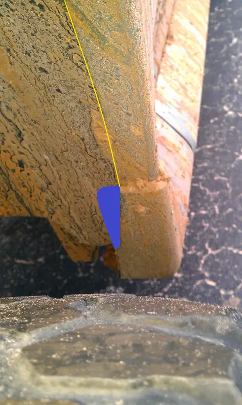

Wrong, depending on the backspacing and offset of the 15X10's you will need to trim. i will post a pic of mine when i had 31's if you look hard enough you'll see some of the inner fender is cut away as well as some of the rocker molding. give me a few minutes to post a pic.
I can't seem to find the other where I cut my inner fender well near the pinch weld. It's not necessary but with my 31's at the time and my 15x10 with a backspacing of 3.75 in I needed it while the suspension traveled while off-road.

ok well you'll have to cut less then I had to so maybe cut what i did in the pic then go from there. my back spacing caused the wheel to rub the inn fender well cause it stuck out more yours will have less dish then mine did, not much but maybe enough.

i put them back on after this pic i just trimmed everything off of them except for the piece that you see like where you had that yellow part where you trimmed it i just cut the whole piece that wraps into the wheel well except for a little piece where it screws in. i also had to trim like 2 1/2 inches off the chrome on the bumper.
oh ok, you mean the blue area right the yellow line was to represent the fender line... i forgot to mention that sorry.
i mean pretty much all of that piece of plastic that is toward the wheel is cut off excpt for a little piece wher i could stil screw it in.
