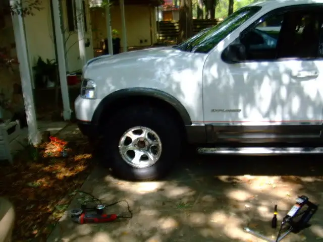

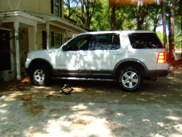

I mounted a 15 inch rim on mine, I had to take aboiut 1/4 inch off the bottom of the nuckle and even then clearance was tight. after getting them on there I really didn't care for the look. that was a good 25,000miles ago no signs of anything negative up front.
i can dig up some crappy pics I took if anyone wants.

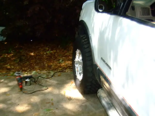

only way to get them in there is to grind and the tire shop must strategically place the weights. clearance is honestly that tight so tight i never pulled it out of the driveway. I was worried it might flex while driving and destroy the rim.
Now that's close!

I wish my truck was here so I could take a look and see what the squared off piece is for. I don't mind grinding it off if its not used for anything.
what do you guys think? should I do it or no? I have the tools to grind it down but idk
