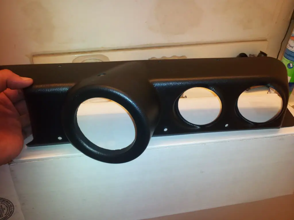

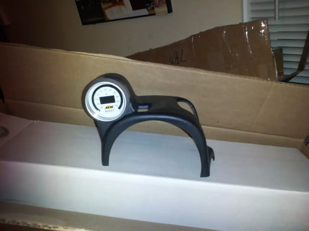

well did my fuel pump today and man was it easy.i have a body lift so i could get to everything on top without cutting a hole or any trouble.whole job took under an hour.also bought some new toys,like i havent spent enough.i got a pod for a 89 mustang for starters and stuffing it with some more gauges.first gauge is the auto meter 5" tach with light(atm-3905)second gauge is a prospect fuel gauge and last is a prospect dual intercooler temp gauge.why not;) the shift light will become my new rev limiter as i wanna raise my max rpms to 5500.im going to cut the fuel pump wire from my ecm and have it wired on a relay so its on when the truck is one and when my shift light come on it kill the power to the pump.im setting it at 5500 but shifting slightly under that.after a dyno run ill see where i stop making power and set it to that.getting alot closer.tomorrow im tearing the glove box apart for the filter and taking all the rest of the coolers of the front to mock up my HE for my intercooler.

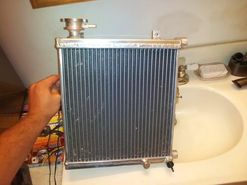

where'd you get the aluminum radiator?
i was talking about the radiator.. but yeah my project runs strong.. getting the tune dialed in on the 12th
