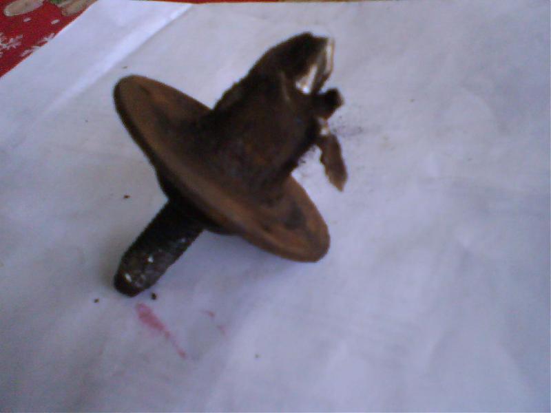

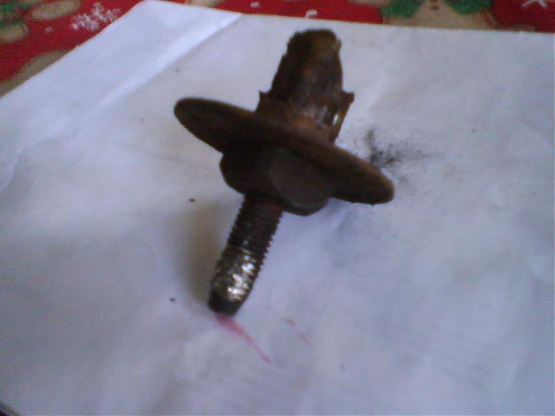

Whats the best way to remove that bolt.? As well the botom of the bushing fell off no ida if thats good or bad.. The other bolt is in the middle where the back seat floor is on pass side the bolt broke inside mount. Not sure what to do about it... Please if anyone has any ida's it would help thank you all..
I used an air impact wrench and they all came out good on my BL. For the broken bolt? Can you get to the nut side? You might have to cut off the nut (if you can) and pick up a new nut/washer.
If you have room, drill out the broken bolt.

As i lay under neith my pass side under the door all i see is the bolt i see the bottom of the nut for the bushing though.. I broke the top right off.
I think im better off maybe drilling it out then buy a new nut /washer

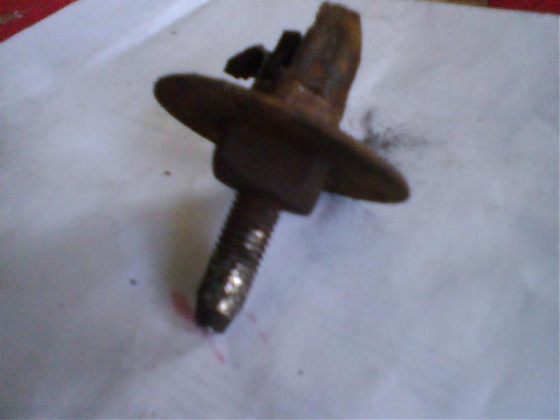

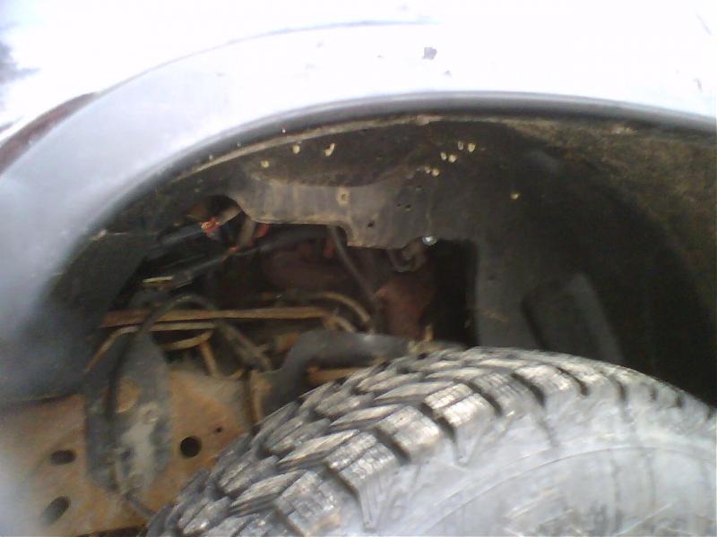

I did finally get that nasty bolt off the bushing it was about 6hrs of hell but got er done... Listed are some Pics of it.

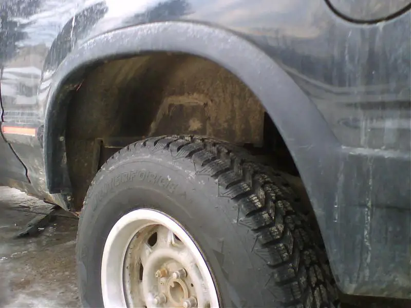

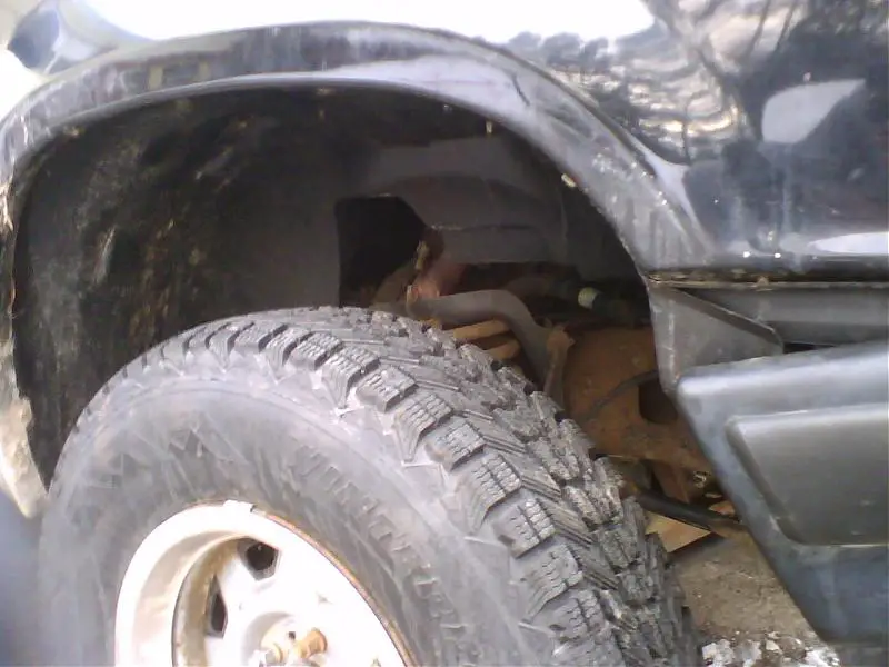

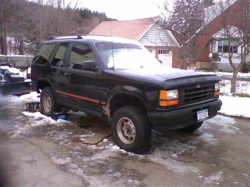

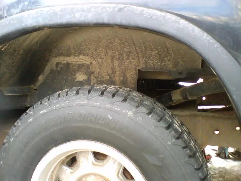

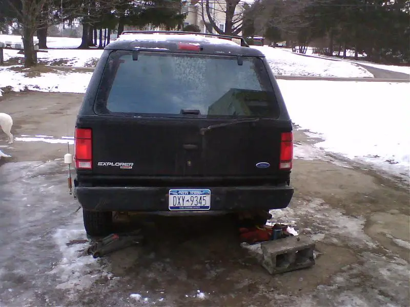

3inch body lift complete somd pics of my new look

Looking good! :thumbsup:
Thanks alot
