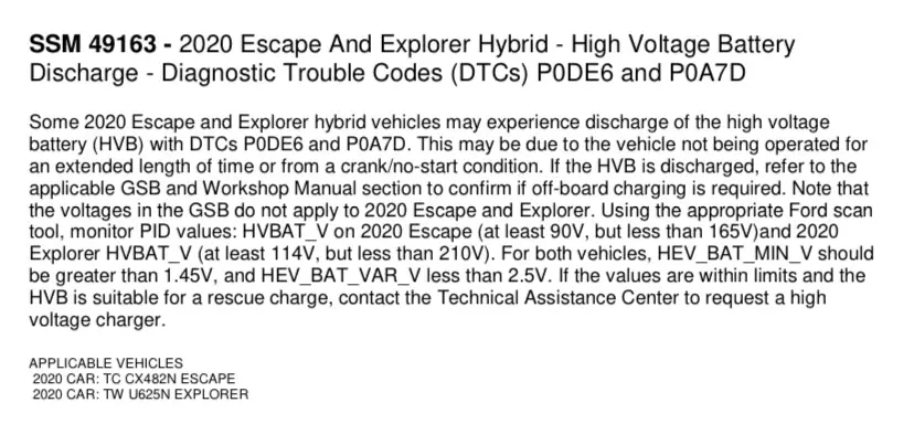

I don’t know if this helps, but it discusses a “high voltage” battery only found in the Hybrids:
The dealership said there were no scan codes, that's part of why they still have it... Plus, I had been operating the truck every day.
