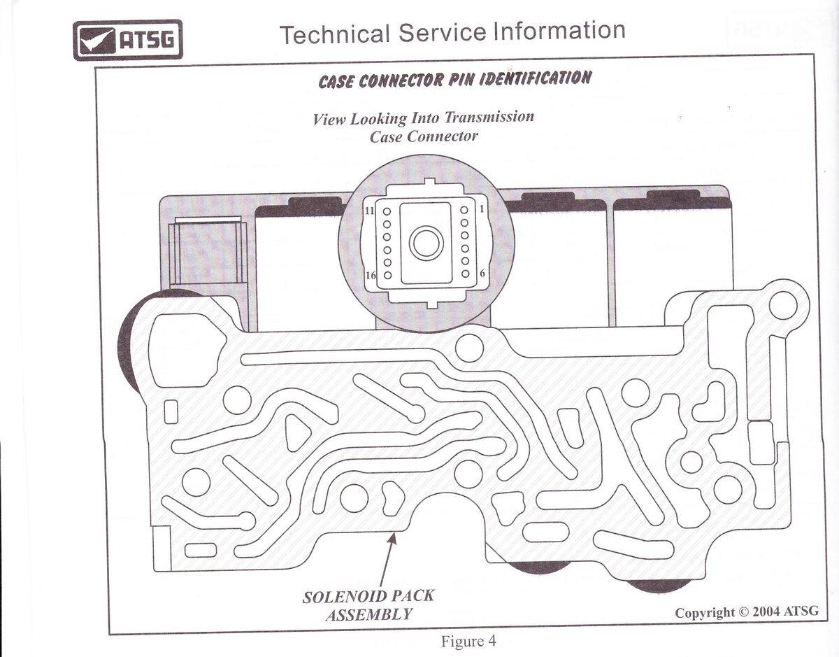

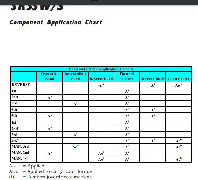

3rd gear is gone.... In second if I Rev up to 4,000 and blip the gas she will go into 4th.... then she shifts into 5th normally.....
Band or Solenoid....
Here is error from code reader:
P0745 Generic Pressure Contril Solenoid A
STFT B1(%) 2.3
LTFT B1(%) 6.3
STFT B2(%) -2.3
LTFT B2(%) 7.0
Engine RPM 2448
What does this all mean?
bad solenoid pack?
Broken band?
She has 150,000 miles...
Has had the “Flair” on the 1-2 shift for years.... not getting worse and 1-2nd shift still works.... just no shift into 3rd...
What to do first?
