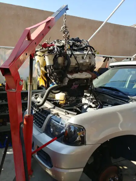

Just an fyi buy a donor vehicle I was lucky to find a wrecked 04 aviator with gray leather w/120k for 1000$. I transferred it all from powertrain to interior took a while but we'll worth it.
So if you really want to do the gen 4 v8 swap buy a donor and you will have everything u need it's all plug n play but be ready to swap everything.
definitely not plug and play when you have to swap every plug before you play
