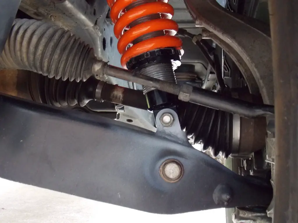

After looking at the suspension some more, I am not really liking the coilover angle I have. The suspension will cycle thru, but I just dont like the angle. The 1st pic is of the way it is mounted now, the second is of how I cut the mount to give me the correct angle. They will mount in the same location but will move the mounting holes forward to correct the angle.

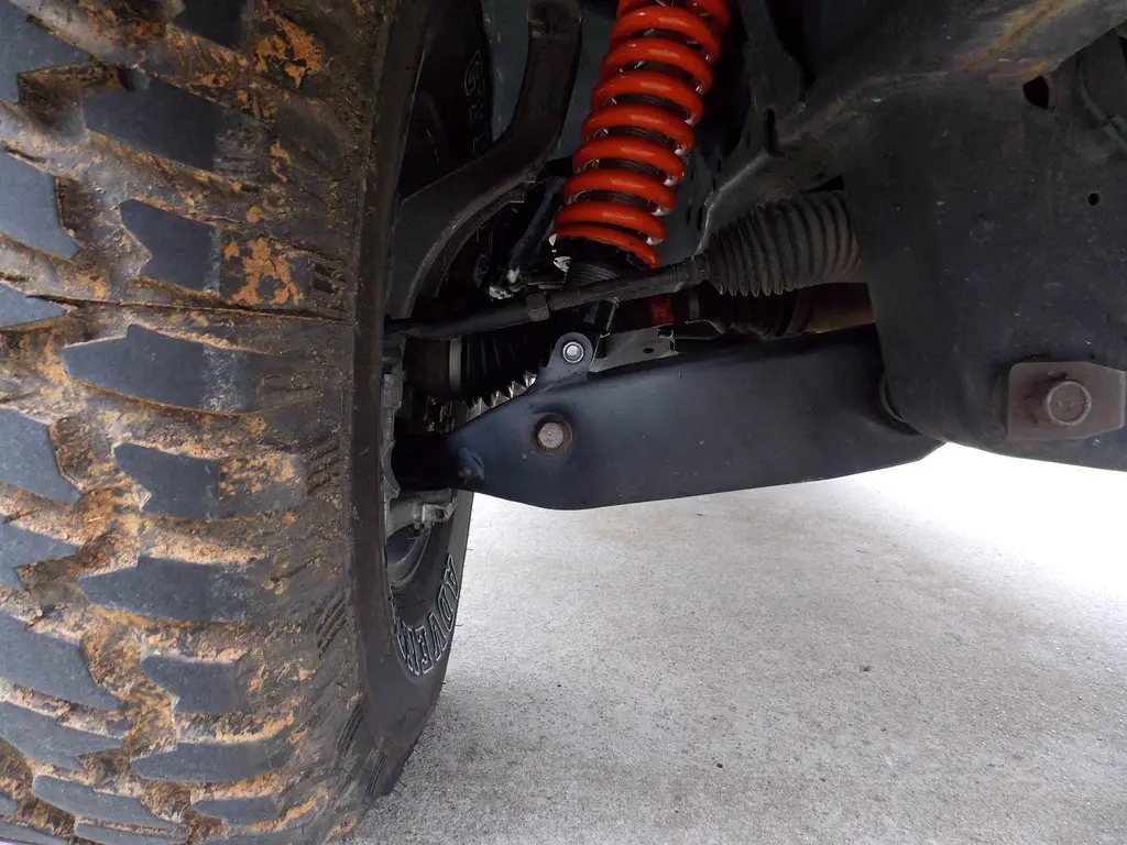

I finally got the lower mounts the way I want, you can see the coilover is very close to be ing the same angle as the factory one.

Nice work...that looks really good.
I'm putting together a 3" body lift project for my truck...when I've finished it I'll probably redesign my mounts again to reduce the angle on the suspension parts a bit as well.
Thanks, should be easier on parts with the correct angle now.
