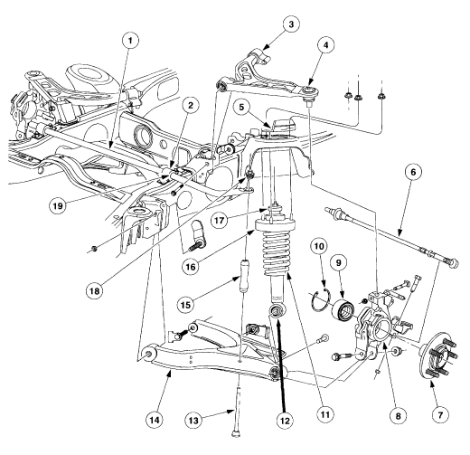

That looks to be a 3rd gen rear suspension, but the 4th gen is similar (upper and lower control arms are a bit different). The brackets needed would be like the front, as you said.
Once I get my front setup done and installed I'm going to see how it rides and assess if the rear coilovers are needed.
