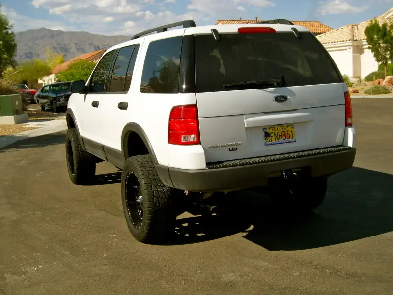

Here is a couple of pics of some explorers I like:
The first one has a nice stance. I could live without the body lift and think some bigger wheels would look nice. It has a 3" spacer lift in the front a 3" body lift and 16" wheels with 33" tires:

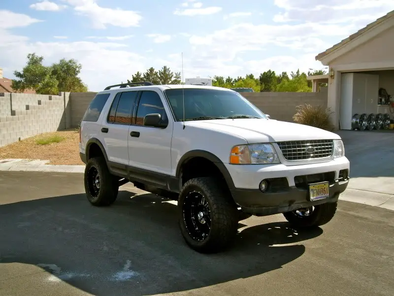

<a href="http://s1197.photobucket.com/albums/aa439/SUL73NAZ/?action=view&amp;current=nosehigh.jpg" target="_blank"><img src="http://i1197.photobucket.com/albums/aa439/SUL73NAZ/nosehigh.jpg" border="0" alt="Photobucket"></a>
The second one has a BTF 2.25" front 1.75" rear lift with a 3" body lift on 32" Nitto Terra Grapplers with 20" KMC Hoss wheels. The back is way too high (sits stink bug). I would also like to see it on some 33x12.50r20 tires because the tires look kinda small on there:
I like the first one. Ronin8002 has a wicked rig. He's running a 1 1/2" bodylift and 1 3/4", 1 1/2" BTF's. 265/75/16's, real nice.
Thank you for the comments! Looks higher in person actually. Measured from ground to top inside curve of the fenderwells is over 38" front and back. Over 13" under the running boards too.
