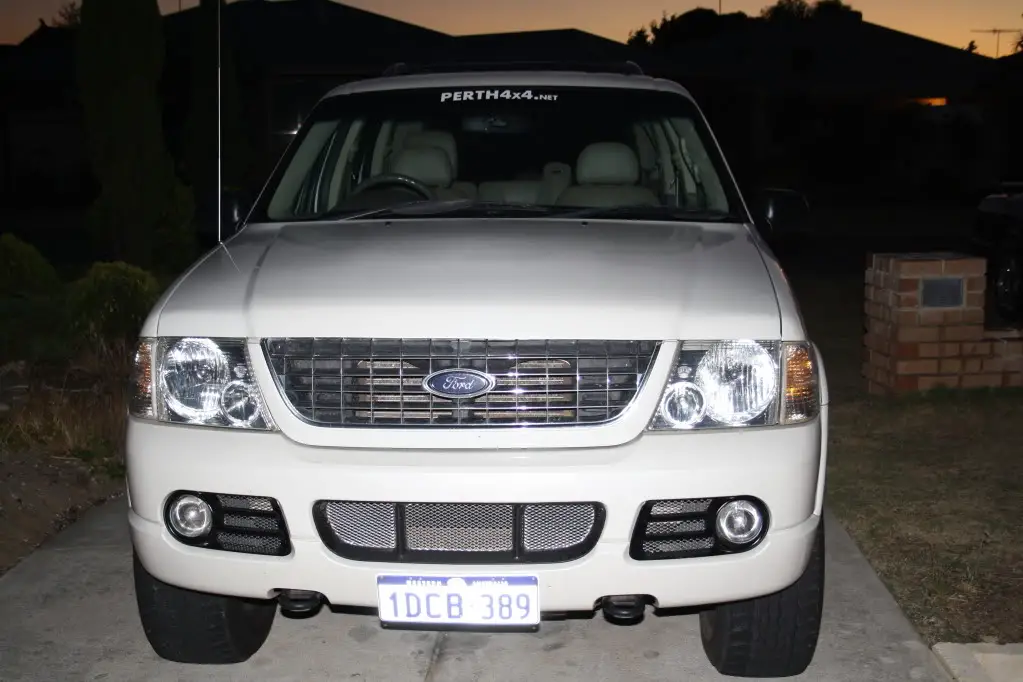

Finally put my fog light bezels back in today after painting them and throwing in some mesh , they came out alright for a trial , is i had more time i'd probably do em a little neater , gotta see how long the paint will last before i do em again.
sorry about the dark photos it was late when i decided to put em in , ill get some better ones during the week.

Nice mod man... did you cut the bezels out so the mesh would show? What did you use to cut it.. what did you use for mesh?

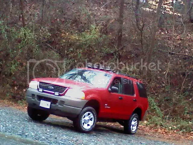

Thanks! I would like to get bigger tires but keep it stock height for now, get a hunter brush guard and tail light guards, and a bigger roof rack and lights. thats all i got for plans so far but im sure i will have many more to come!

n. gardners ex is lifted, check his sig
i have running boards, i think theyre goin on next week for the snow

Yeh mate i cut the plastic stuff out and stuck the mesh in behind. I used a sll hacksaw blade to cut the plastic as close as i could to the edges, then used a miniature file set (like a hobby set with straight, curved, round etc..) to smooth it right back. And of course painted em gloss black while i was at it. oh and the mesh i used is just the stuff u buy from an auto store , its jus generic mesh that gets used alot in ricers for their bodykits and such.

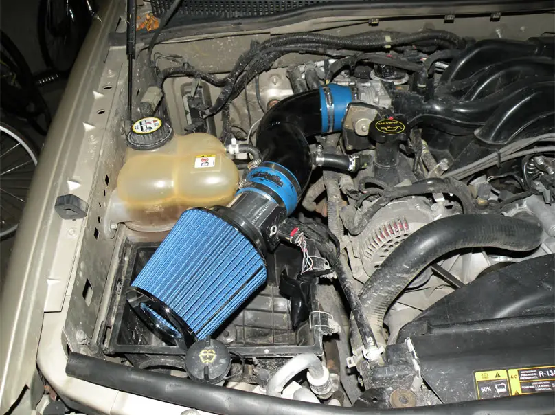

Yeah, I also have an intake on my explorer. You can run the "stage 2" which is the stock airbox with 3" tubing, or you could try my route...a cheap $30 intake with another $30-40.00 for the MAF sensor adapter. My MAF wires were exposed in this pic, but I've re-done the tape.

i really like the way you did yours, what all did you have to get before you could put it on?
and the 3" tubing would just need connectors to properly connect to the airbox?

This is caldwell's set-up. No messing with the MAF sensor
My set-up involves
Spectre MAF sensor adapter
And an intake that's not available anymore. You could do caldwell's set-up and use the adapter that's provided above and do an open cone filter.
Here's the Stage 2 intake write up.

thanks man! this really helped me! by the way i like your explorer and the 4.0 badge!
