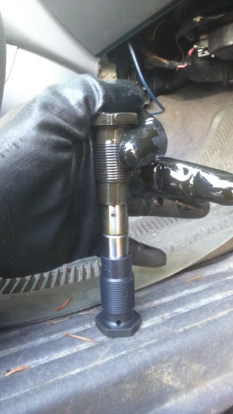

Two questions- firstly can anyone show me the comparative spring strength between aftermarket and Ford OEM tensioners? This is an old worn ford one (probably) versus the aftermarket one:

These are hydraulic tensioners. When full of oil (like they should be, in use), they are rock hard. Spring is secondary, and probably there mostly to (rather loosely) hold the guide against the chain until the oil pumps up at startup.

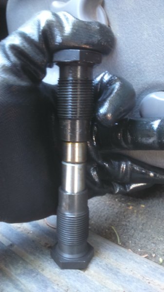

So here's the aftermarket (above) vs the OEM (below):
As can be seen the OEM part has LESS tension on the spring. Which means, by logic, MORE lash in the chains at startup, thus more chance the motor will skip timing in that first second. I read over on the ranger forum about people still getting the rattle after installing these as well, which makes sense..

Thanks guys! I found the old tensioners I took out and lo and behold the spring tension is exactly the same as the new OEM parts.. As the rear one is always full of oil I'll leave it for now but the /old/ rear one is going to become an experiment similar to the one in the vid..
