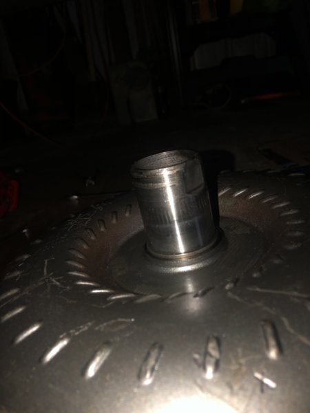

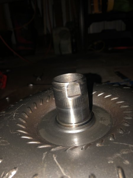

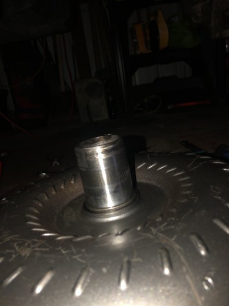

Okay so just a little update, been taking a break for the past week or so but finally got the transmission back out to inspect things and it looks like where the torque converter slides into the pump has had some metal to metal contact because it’s been scored and looks like it got a little hot so clearly I didn’t have it seated properly. Will try to upload some pictures of what I’m talking about, also the input shaft that goes from the transmission into the TC will not spin by hand (put it in neutral in case, don’t know if that matters or not), is the shaft supposed to spin freely by hand? I thought it was supposed to, could that mean the pump did in fact get ruined and possibly bound up? Note when I removed the cooler lines nothing came out but maybe a couple drops, I know it wouldn’t come out as a steady flow or anything but if the pump was working there would’ve been SOME residual fluid in the lines that would’ve dribbled out right? But they were damn near bone dry so it’s definitely gotta be the pump. My next question is what exactly happened inside the pump or what should I expect to find in this case? Could this have ruined the rest of the transmission?

Going to need a pump and new converter. Also will need new pump bushing in bell housing. Those can give you a rough time as they are a machined it place. I have changed several without machining with no known issues. Do it at your own risk if you choose to change it out. Will also need an alignment tool to put pump on bell housing.

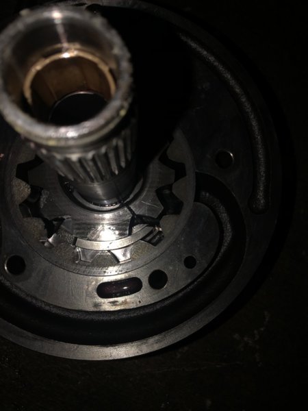

Thought I’d share this, just confirmation that it was the pump. Small gear broke on one side...any advice on joining the transmission and engine making sure the new converter is seated properly this time? Cost me almost $500 total (pump, TC and fluid) so would like NOT to make this mistake again lol
