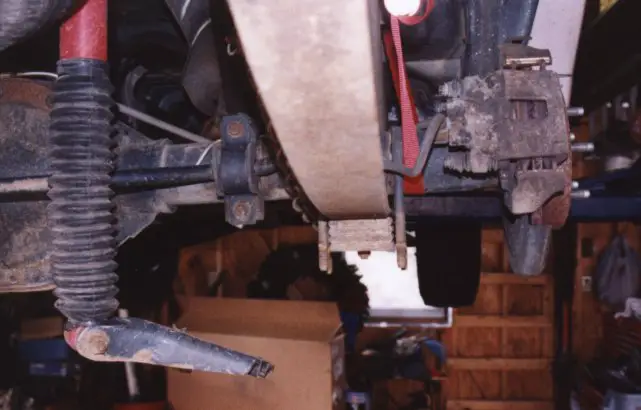

Removal:

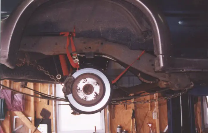

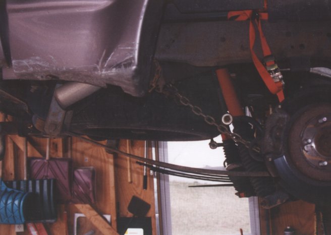

1, Remove Rear Tires.
2, Support one side of the rear axle.
(To do this, I used a Ratchet Strap To lift one side of the Axle at a time, and I also used a Chain as a "Saftey" in case the Ratchet Strap broke...)(Also I performed this Mod while the Explorer is on a Lift, 6ft in the Air....)

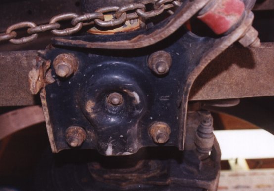

3, Separate the rear spring from the rear axle.
-A, Remove the four rear spring U-bolt nuts.
-B, Remove the two U-bolts.
-C, Position the rear spring plate aside.
(On the Passenger Side it is Necessary to remove the Emeregency Brake Cable Bracket from the spring plate, to do this you need a 10mm socket.)

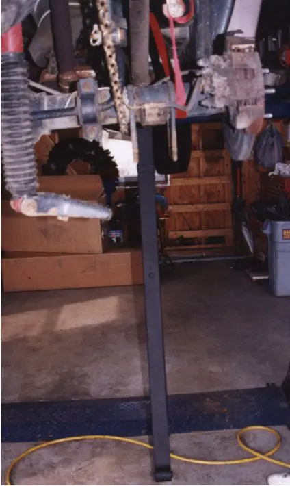

4, Remove the nut & bolt holding the rear shackle to spring.
5, Remove the nut & bolt holding the spring to front frame bracket, and remove the rear spring.

(I had to losen the U-Bolts from the 2nd side while tightening the U-bolts on the 1st side in order to get the Axle to Twist a little so that the U-Bolt Spring Plate could be flush up against the spring)
3, Install the rear spring plate.
-A, Position the rear spring plate underneath the spring.
-B, Install the two U-bolts.
-C, Install the four rear spring U-bolt nuts.
-D, Tighten the four rear spring U-bolt nuts to 65-87 Lb/Ft.

4, Lower the rear axle onto the spring.
(making sure you have enough slack in the saftey chain to remove it, when you are done.)

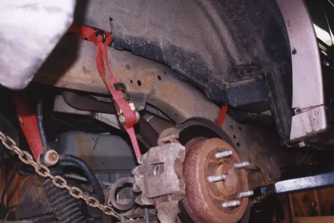

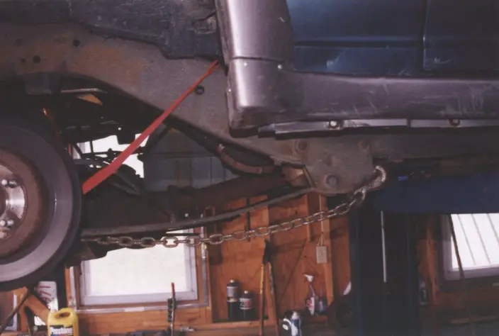

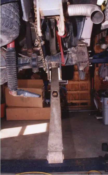

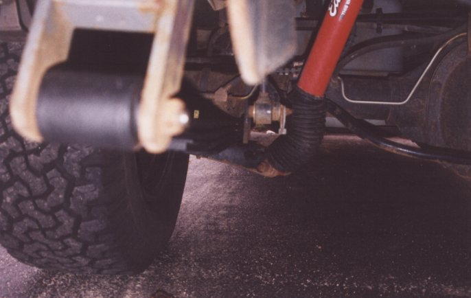

Here is my "After" Shot:
