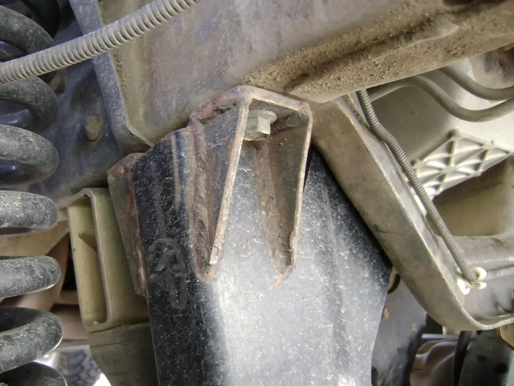

If you do go with that kit make sure and weld some gussets on the biggest drop bracket. It looks a lot like the Superlift bracket and they have been known to break, mine did....
this is how I fixed it......
Gussets front and back, inside and out. Haven't had any problems since....
Thanks for the tip Bloodbane. I am about to install the same kit on a friends Explorer so I will gusset it before installation.
