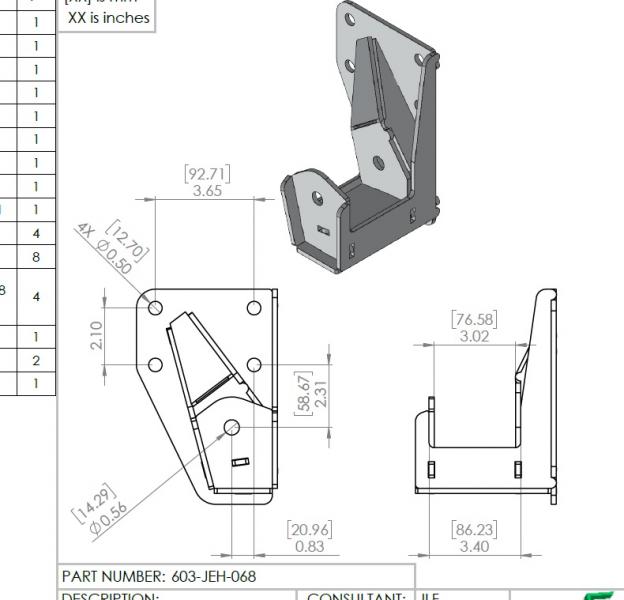

With the help of a friend I was also able to download a ranger long travel leaf spring hanger design from DIYoffroad.com, it looks like we will be building our own rear hangers... my friend has a plasma table and is willing to help me create some custom hangers!! oooooh la la
This design will get modified, I need my hanger to be about 4" rearward of this design to allow the proper shackle angle
good find! I have a new fav website.
what's your plan for the rear shocks? bed cage or build into the wheel well?

Rear shocks will be setup once I have an axle in there, ride height set and suspension flexing. I am hoping to keep them somewhere near the stock location for this build
