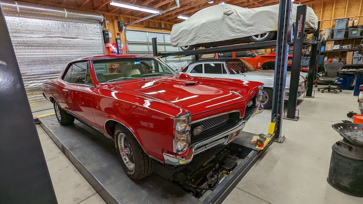

At the end of every summer I am swamped with work I put off. I tell my friends whose cars I work on that I will let them know when I'm done and can get their cars back on the lift. In fact just stepped in the house after working on this one.

That's sexy

410Fortune posts about getting 33" of snow, and Rick puts up a picture of his garage door that's insulated to keep the heat out.
It's 68 degrees, behind him is the kerosene torpedo heater not shown in the picture.
I love that car. @Rick is that a milk jug with a old tractor seat welded to it in the lower right corner? I have both of those, but never thought of making a stool out of them. Genius.
Yes, I have a couple of them. I used to be able to get the seats and jugs for like $20 a piece. Haven't seen them that cheap for awhile.
