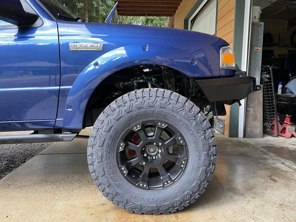

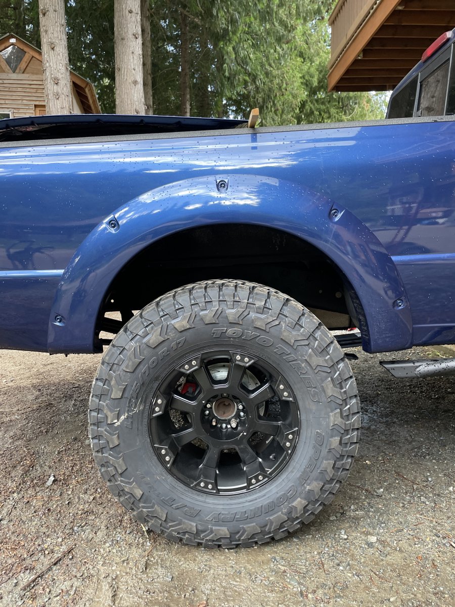

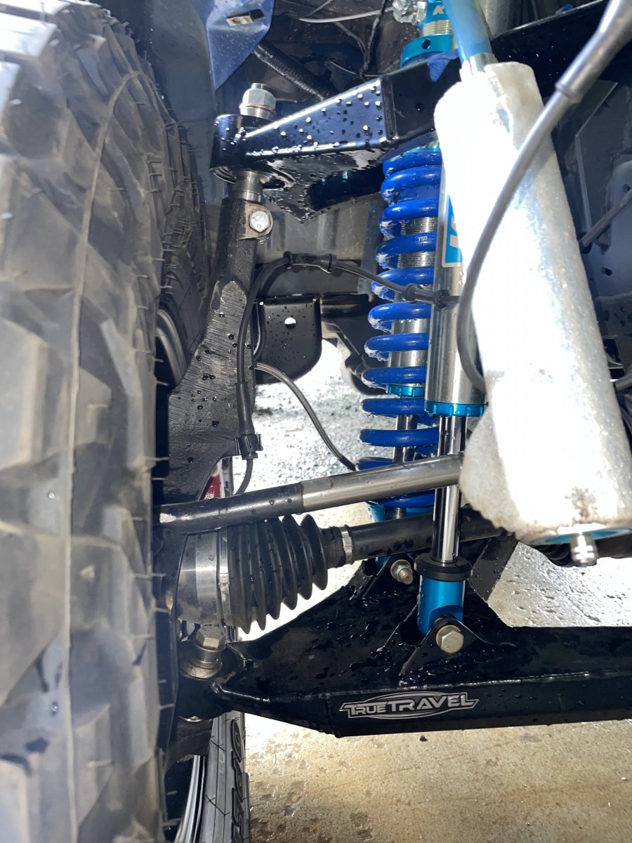

Tire clearance, Clarence
Tire coverage

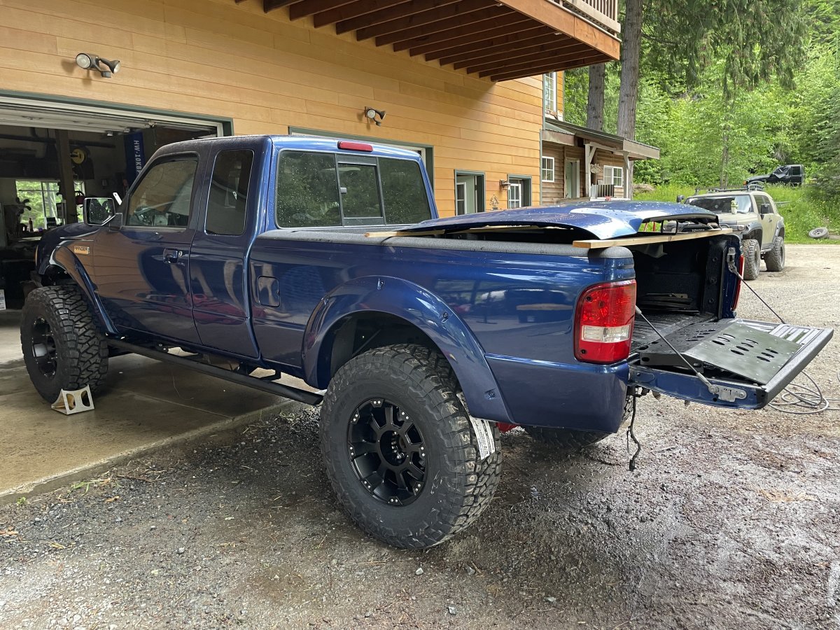

Glass was the right choice for this truck! She’s standing tall ;) hood is several inches higher then my bronco that is for sure
