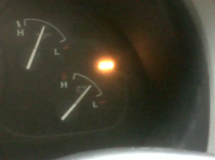

Well I am 95% done. Just have to wire up the 4wd lights. everything looks and works good so far. Can't wait to get off road and have real 4wd!
How my shifter works.
Well its all done! Got the lights wired up tonight. Left both of them light up for 4wd low because it draws more attention if somebody is driving my truck and they don't know anything about 4wd. Would like to figure out a little better way for the plastic housing to stay in place but when it is in 2wd (and will be most of the time) it looks and stays fine.

a relay would fix both lights coming on at once. basically you need a 12v source (I stole mine from the lighter) to run to one magnetic terminal and run the other to 4lo ground signal
run the 4hi ground signal to the center switch pole and 4hi light to the normal closed contacter and 4lo to the normal open contacter
Ya I know it's not that hard to wire it up, I just like idea of how bright both of them are to draw attention to when in 4wd lo. It won't get used very often. So when people drive it and see the lights they will know that something isn't right.
