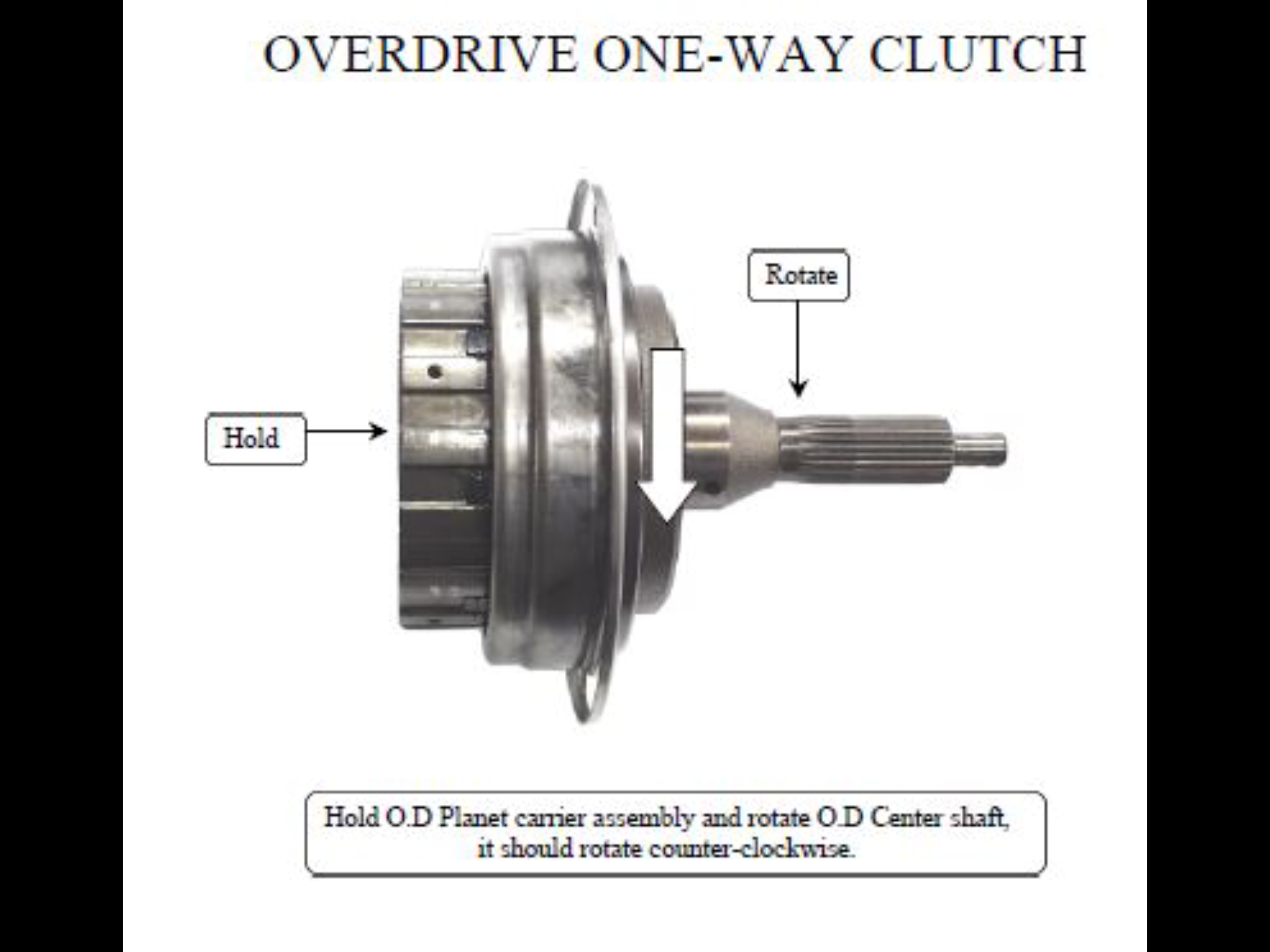

You would still have reverse if the low sprag is in backwards because the low band holds the drum anyways.
The input sprag has to overrun for 2nd and it has to hold for reverse and you have bind in 2nd and no reverse.
Hello
So reinstalling the OD sprag correctly will give me reverse?
