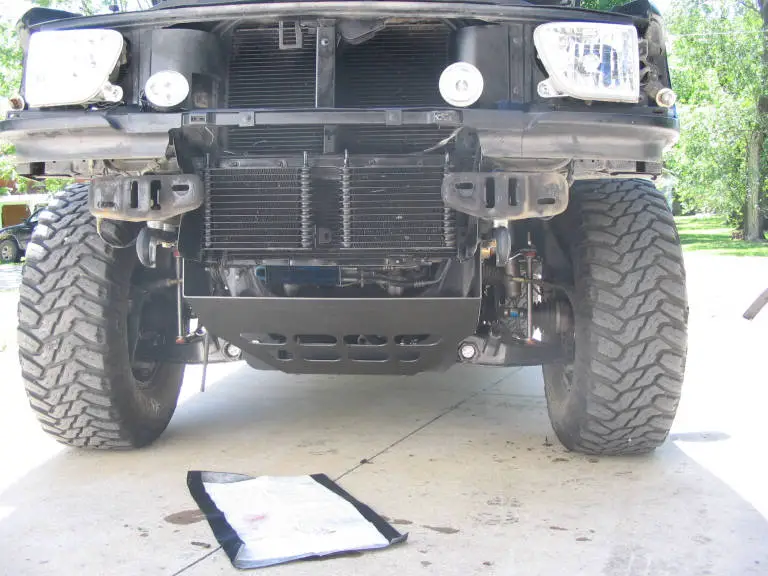

Here's what I did, just for throwing ideas out.
2 stock explorer towing package coolers side by side. These have real good flattened tubes for great heat transfer
and with fans. 2 10" with 180 degree "on" thermosat.
Hard lines for fluid added
attachment.php
with bumper in place. The trans coolers do not penetrate into the grill openening
