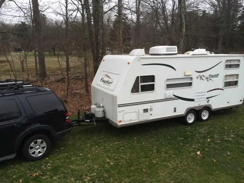

I recently brought my 07 explorer to trans shop because, 1) the O/D off button would not work, 2) the plastic "chrome" shifter cap was flaking, and 3) I wanted to inquire about an upgraded trans cooler. The shop fixed 1 & 2 by replacing the entire shift mechanism with the correct ford part but they responded that the truck already has a large trans cooler, running it stock is the best bet. Even when I inquired, can they put another one on there is series they said no, it won't be any better. I assume the 4th gen explorer has a suffient transcooler that takes up the entire space available. So off to towing. The Here is how I did it. I tow the camper with mine explorer.

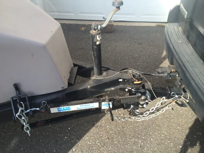

And I'm rolling with my weight distribution hitch
