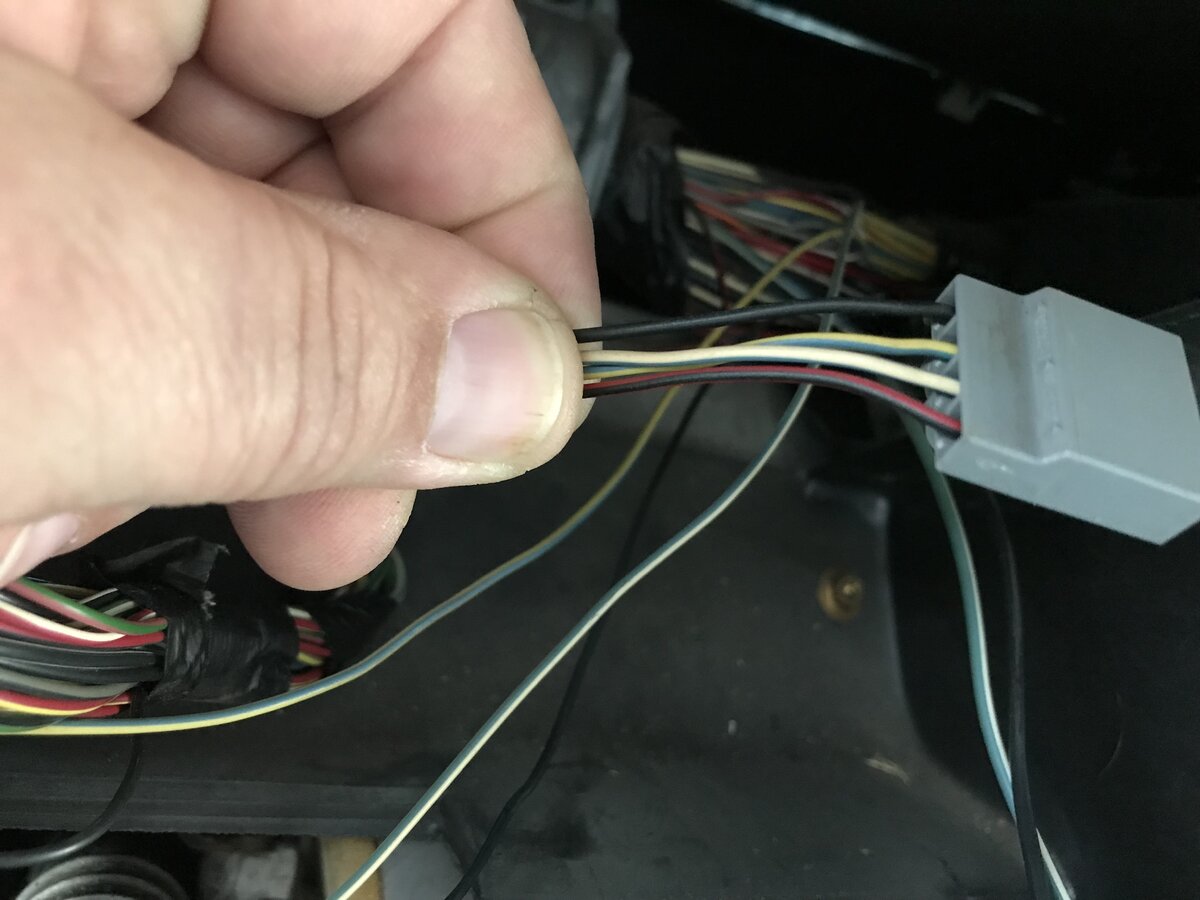

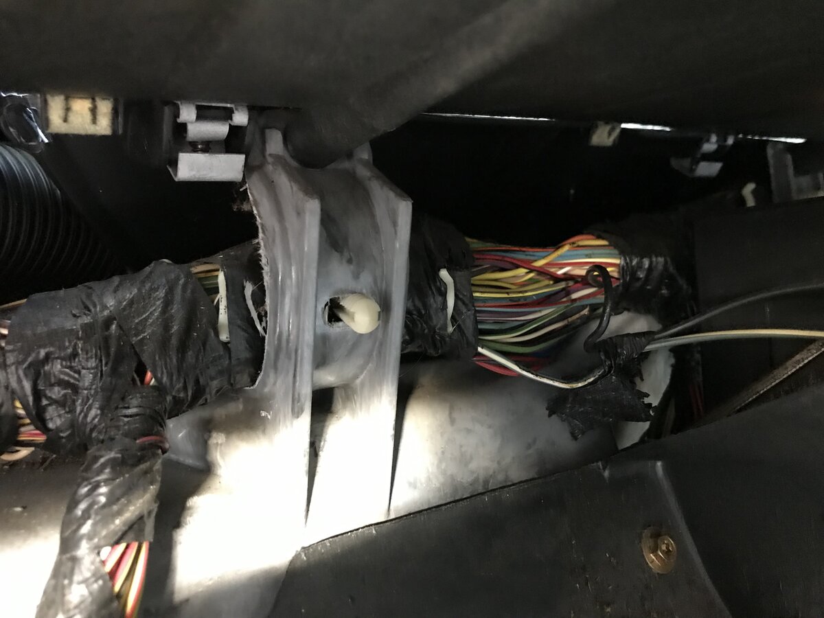

Would you happen to have a wire diagram of where the wires needed will terminate. I removed the bezel on the 4x4 and looks like 4 wires go into the harness. I think one may go to fuse Box and 3 maybe to trans case, should the modules in dash be to the left of the radio be swapped and should I swap the computer from the 4x4 donor into the new build? I will get some photos up this weekend. Thank you again.

Where to hook up 4x4 switch wires? Thanks
