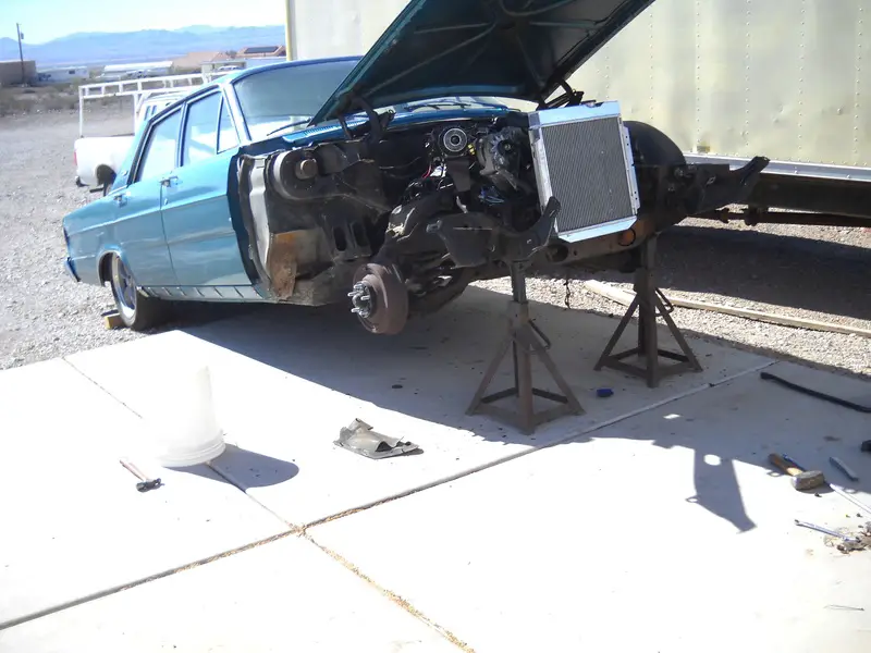

This type of conversion I have done numerous times, with very satisfactory results. The EFI harness out of a wrecked Fox Body is less costly than buying a brand new harness. The latter was used in this '65 Galaxie:
