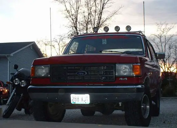

I meant to say I liked what willzilla had, but I don't have the system down here, yet. I liked his clips. I don't really have or want to spend more than $100 on it right now. I have $100 to make it another 4 days. Or I can drive my Ranger with the exhaust issue, because it sounds louder, but I'd like to hear a nice, low hum from the Explorer. I had an 89 Bronco with the cats cut and dual cherry bombs, and it sounded great, but highway trips were draining. I'd just crank up the music. I can't do that with the girl, she already says it's loud.
Old Bronco:
Old Bronco:
