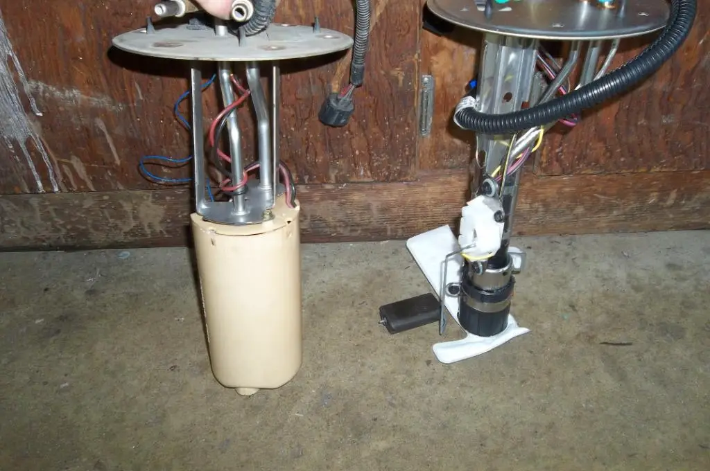

Fuel pump comparison
Here are the comparison pictures between the 2 style of sending units used in 95-01 explorers. The plastic canister one is used in 95 & 96 explorer's and the other one with the pump exposed is used on 97 and up explorer's.
As you can see in the following picture the Walbro GSS340 pump doesn't fit in the cansister very well. It bulged out the side and top.

Thanks for the pictures. The two styles should work the same, given the pump and socks mounted at the same level. I see that you have new parts there. I also bought a new 91-94 style assembly, and recently decided to make the later(98-01) style work in my old 93 tank. So I have more spare new parts unneeded.:(
