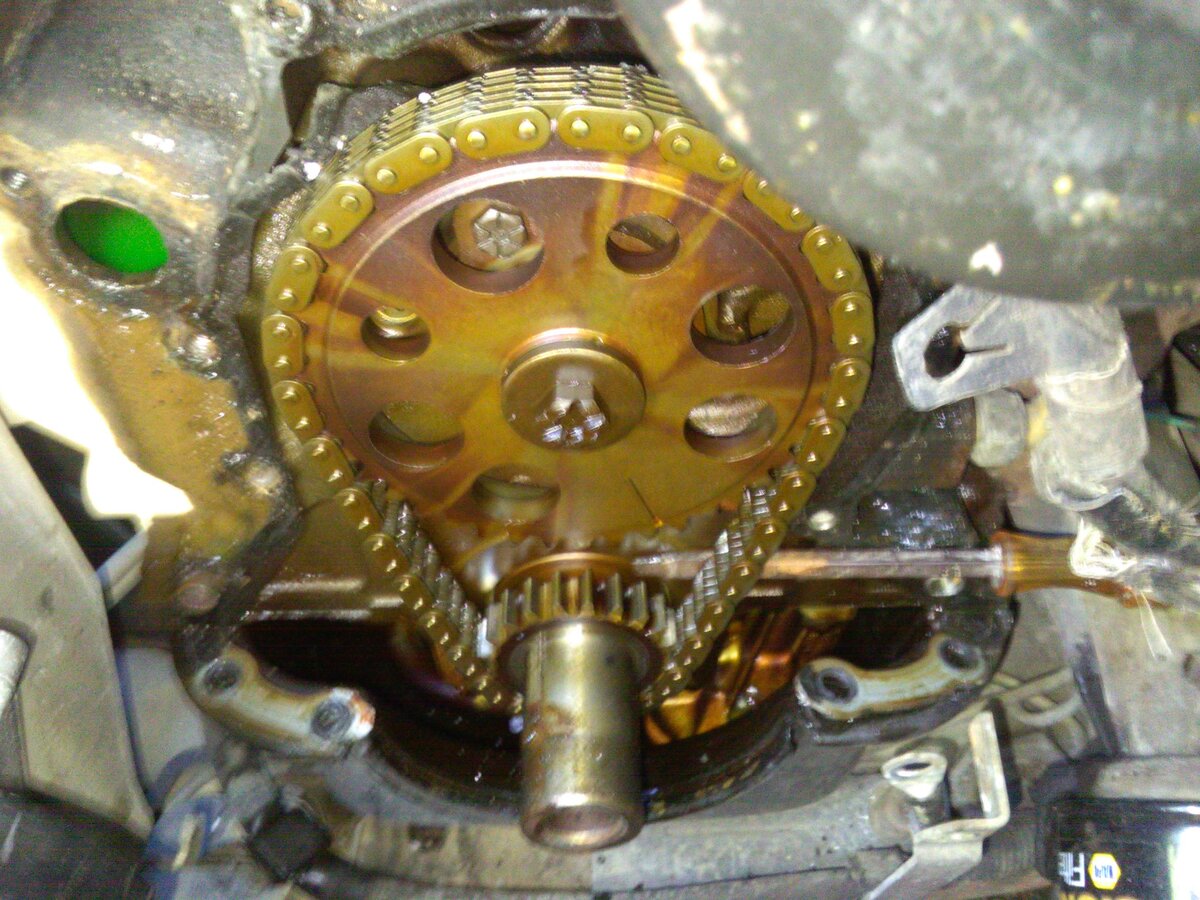

I have replaced the timing cover gasket on 4 different 5.0 vehicles due to coolant leaking. The oldest repair is about 4 years old and 50K miles, no leaks. Of the four, one has started leaking again, top passenger corner, and it was installed about 2 years ago, 25K miles when it was leaking at the same place. I have it removed now and when I put a straight edge on it, there is a gap that I can see light through at both of the top corners where the cover connects to the coolant ports. I could measure if that would help anyone with giving advice. I have tried K-seal, others, slows it down but eventually leaked again so now I have it removed. Below are my ideas, what would you recommend?
Option 1 - purchase new timing cover, Rock Auto has ATP 103039 or Pioneer 500302T (other?) Any preference for replacement cover?
Option 2 - I have a perfectly flat surface, rubber cement some sandpaper on the surface and level out the timing cover so the two outer edges at the top are flush with the rest of the cover.
Others?
Thanks for sharing your thoughts and experiences.
