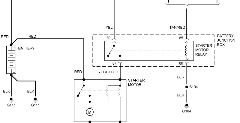

wiring diagram

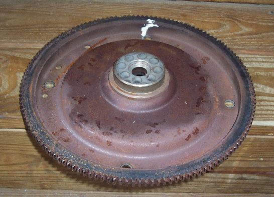

You might try swapping the starter motor relay with another identical relay in the battery junction box. However, I suspect Fuse 5 is blowing because the starter engagement/release is faulty causing excessive current to flow thru the starter solenoid. If replacing the starter does not fix the problem the teeth on the flex plate may have been damaged by the starter.
