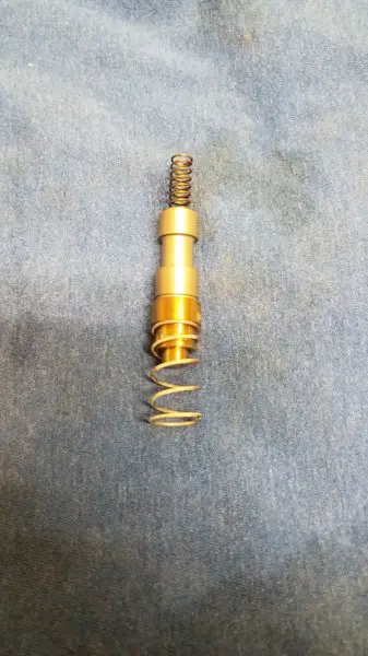

There is a thermal cooler bypass valve. Until the transmission is at operating temperature it just recirculates the fluid in the pan. Once at temp it opens and adds the cooler in. It may be sticking or installed incorrect. I have been disabling this feature for years with no problem just got that reason. I’m not saying it is right or wrong it’s just what has been working for me.

How much lower are the trans temps after this? Are there any ill affects? The entire reason I did a vb swap was for the thermal bypass valve that comes in a superior shift kit. I still have high temps after installing it.
It’s not a fix for overheating it makes it slightly more efficient but make topping it of with fluid a lot easier and takes away the possibility of it sticking closed and not going to the cooler at all.
So this entire assembly is removed? Does the keeper under the separator plate stay in?
I appreciate the responses too!
