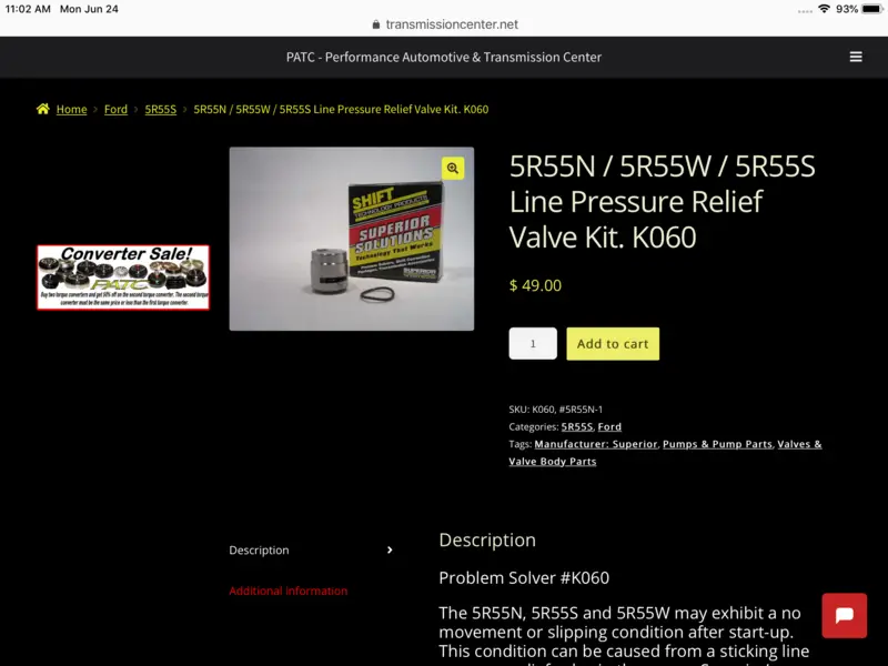

While it’s out I would replace the line pressure relief valve. If sticking closed would cause high line pressure and damage parts. If stuck open you will have a no move or delay. Have to be careful on correct pump alignment after taking apart. Valve body gaskets on this model don’t give problems and they are bonded to the separator plate. Get a new bonded plate from Ford if you decide to change.
