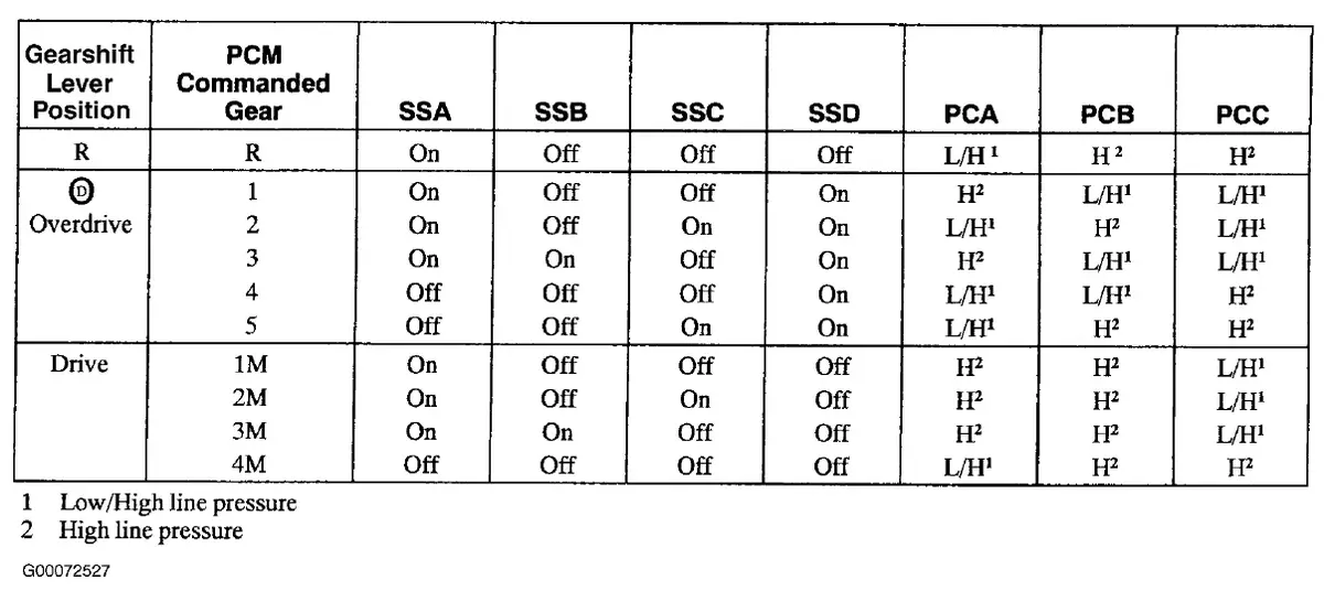

I've got a 2005 Explorer with a 5R55S transmission. I think the servo (or servo seal) is going out on the "D" automatic setting. I can hear it trying to engage, but it just slips. I can manually put it in third and drive away, though. When the transmission is manually put in 3rd gear (or 2nd or 1st, for that matter), is that done by direct linkage or does it use a hydraulic servo the same as if it was shifted automatically?
When I shift it into 3rd, I can feel a detent in the shift lever that's different than when putting it in the "D" position. I have a very-short-term reason for wanting to know how reliable the transmission is in manually-shifted 3rd gear. Does anybody know?
