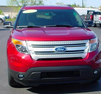

well I finished my little project with help of some examples here. I installed the drivebright DRL but did not like the black side of it against my standard silver grill so I plasti coated it, leaving the chrome strips intact and placed a black and chrome Ford logo in place of the blue stock one.. I also put in a 22" LED light bar on the bottom of the bumper. I had purchased a bull bar 2 years ago but could not bring myself to mount it, did not like the look for my truck. If I had done the LED lbar on the top of the bumper behind the grill I would have lost some of the output due to the narrow opening (I could have used a single row but had this in stock and it puts out more light). First picture, before is a stock off of the internet as I never think to take pics before or during.

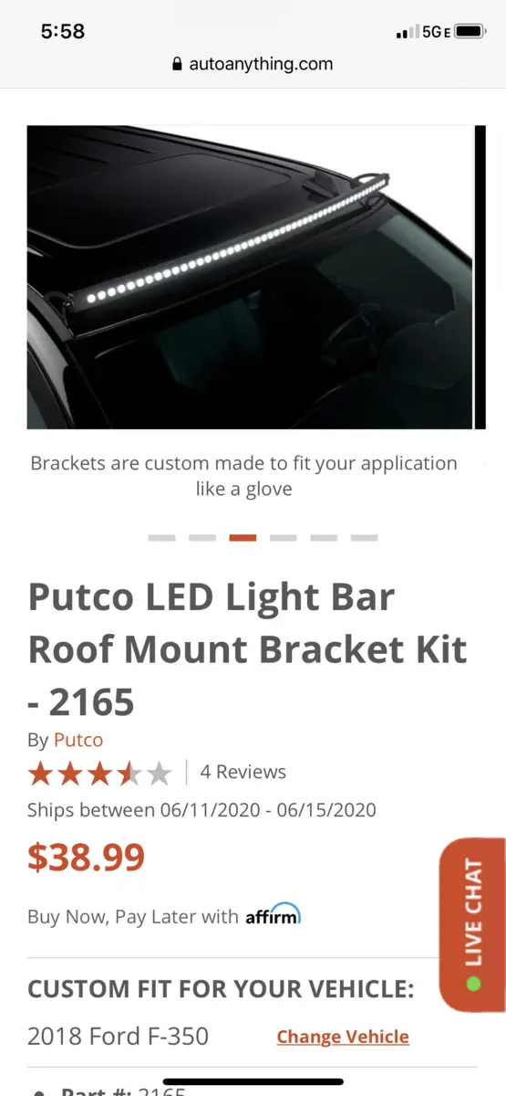

Ken Block just pumped out a Explorer ST with a light bar on it.. By the looks of the bracket, its in the roof "gutter" or whatever thats called. I tried reaching out to rigid industries to see if they provided the bracket but, of course, no replies... Looks like a custom bracket. I think if you found a short bracket with a flat mounting position, you should be able to mount it into the "gutter" just above the windshield.. Ive been tooling around with this idea for a while.. Ended up attaching it to my roof basket.. Which is nice actually because I can remove the light-bar when I take the basket off.
I found this photo while looking for some brackets the other day. I wonder if we could do something similar on the x’s

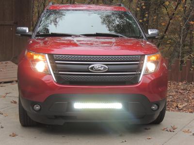

I bought a 12" light bar that I never installed, now I'm going to install a new 23" light bar behind my grill on the front bumper.
How did you install? That’s where I’m thinking of putting a light bar also. How is the light output with the bar being that low?
Best I can remember, I removed the front bumper clip. Drilled into the metal frame above where the light bar sits and mounted it. Putting back the bumper clip without the lower mesh grill, then cutting the grill open to fit around the light and pop it back in place. Wiring is just that, a relay to power, trigger off of the high beam wire and a switch in the passenger compartment to turn it off if needed. It comes one with the bright lights. Light is good for my use but of course, higher would be better.

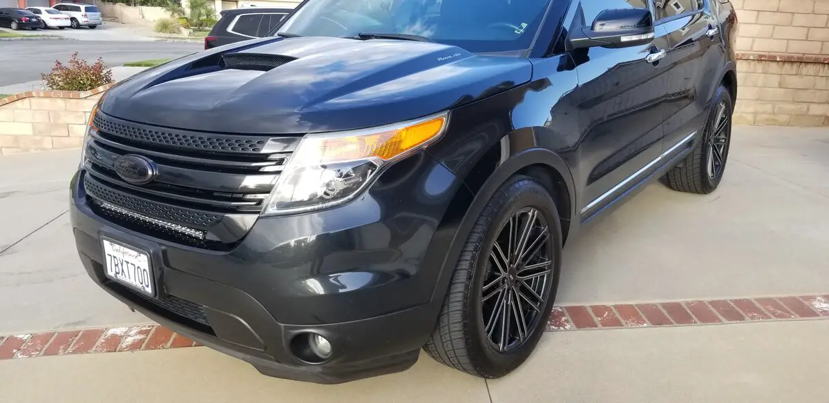

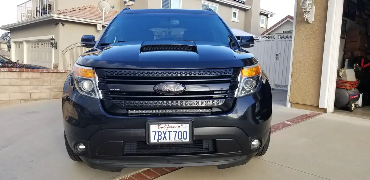

I had a 14' Explorer before and I installed a 25" single row light bar in the opening between the the grille and the bumper. I bought a 17' Sport now and I'm going to attempt the same thing. I removed the front left wheel and removed the fender liner and ran the wires for the switch through there into the vehicle. Very limited where you can run wires. I drilled a hole a ran the wires through a grommet. Came out super clean. Looks factory!

Can we talk about your hood for a few minutes? That looks very sharp and I'm curious where this was acquired at.
