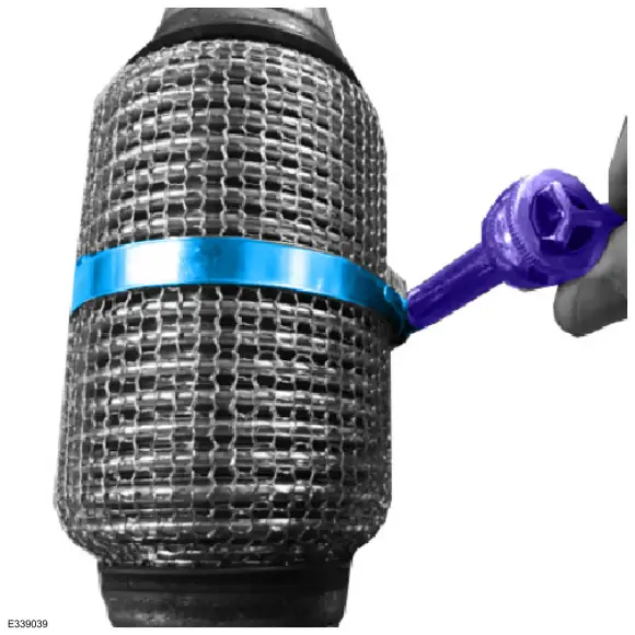

TSB 20-2220 Exhaust Rattle Noise – 2020 Ford Explorer & Lincoln Aviator
Exhaust Rattle Noise – 2020 Ford Explorer & Lincoln Aviator​
oemdtc September 14, 2020 No Comments
NHTSA ID Number: 10177124
Manufacturer Communication Number: TSB 20-2220
Summary​
Some 2020 Explorer/Aviator vehicles may exhibit a rattle type noise originating from the exhaust flexible pipe. This may be due to the natural harmonic frequency of the pipe. To correct the condition, follow the Service Procedure to install a worm gear clamp over the exhaust flexible pipe.

Issue: Some 2020 Explorer/Aviator vehicles may exhibit a rattle type noise originating from the exhaust flexible pipe. This may be due to the natural harmonic frequency of the pipe. To correct the condition, follow the Service Procedure to install a worm gear clamp over the exhaust flexible pipe.
Action: Follow the Service Procedure to correct the condition on vehicles that meet all of the following criteria:

Obtain Locally90 mm (3.5 in.) Worm Gear Clamp1 Per Exhaust Flexible Pipe
Warranty Status: Eligible under provisions of New Vehicle Limited Warranty (NVLW)/Service Part Warranty (SPW)/Special Service Part (SSP)/Extended Service Plan (ESP) coverage. Limits/policies/prior approvals are not altered by a TSB. NVLW/SPW/SSP/ESP coverage limits are determined by the identified causal part and verified using the OASIS part coverage tool.

  1. Open and install the worm gear clamp over the flexible portion of the exhaust flexible pipe. Tighten to 2.7 Nm (24 lb-in) (Figure 1).
Figure 1
