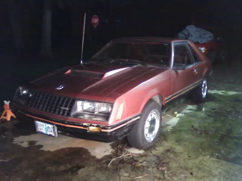

It's nice to see someone taking an interest in these old girls. They are the forgotten Mustangs. Looks to me like you have your centre caps on wrong. They should have a crown to them, not indented like yours are. You need to push them onto the wheels by the outside edge, not in the middle.
Here is my '79 Mustang. She's an original, numbers matching V8, 4spd, TRX car. Bought by me in Feb 1991. This picture is from the summer of '92. It's time for paint again, hopefully this winter. Also have an '86 4cyl notchback.

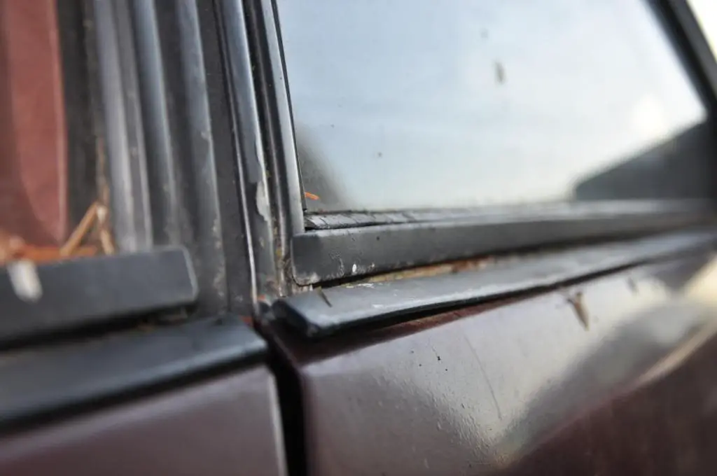

Be extremely careful with the blackout trim that is on the door edge and below the quarter window. It is worth it's weight in gold. The trim below the quarter window bolts on from inside the car. You have to take the interior trim out to access it. It DOES NOT pop out like the trim on the door. If you try that you will destroy it and believe me, it is just about the hardest trim piece to find on these cars.

thanks for the help paul! I haven't pulled any of those pieces off mainly cuz i'm unsure how to get them off. that and I REALLY don't have the time to take care of the mess I'm going to find.
