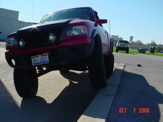

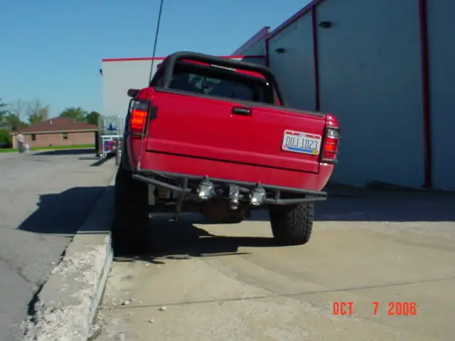

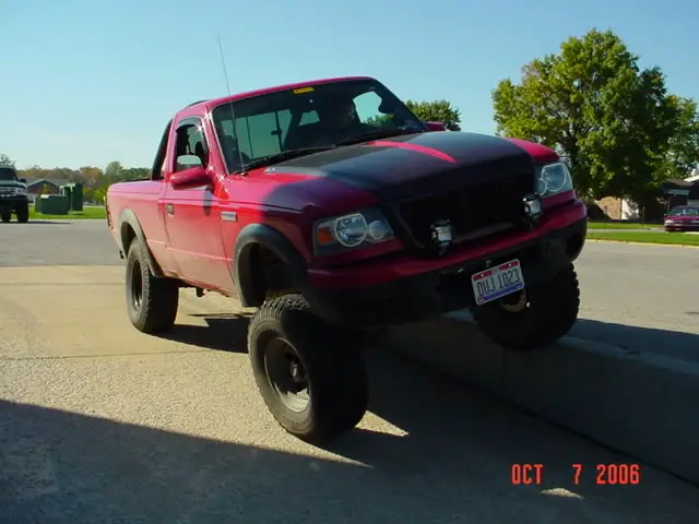

Went and got my spindles installed and 2inch block in the rear at gumbys(r-f.com) house, thanks for the help man!!
now only if this bucket will only flex
Heyyyyy, your over on RPS too! Truck is looking really good, I like it alot better than when you had it lowered. What size tires are you running now? 33x12.50s? Anyway, truck looks good up in the air. :thumbsup:

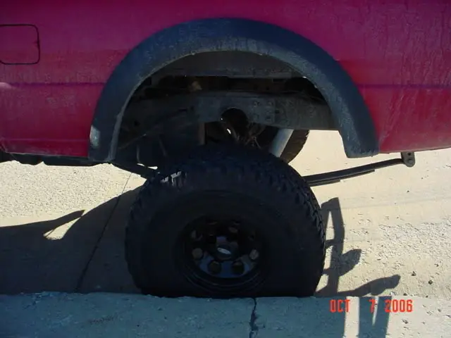

Did you use the Chevy spring shackles in the rear?
im running a stock edge 2inch block, 97 explroer 4x4 4dr springs, and a chevy lowering shackle
and its got 33x12.5x15 bfg allterrians, looking for a 35 or 36
Use to be a lowered truck? or whats up with the rear bolt in c-notch?
Thought so, saw the 2 sets of holes on the shackle.
