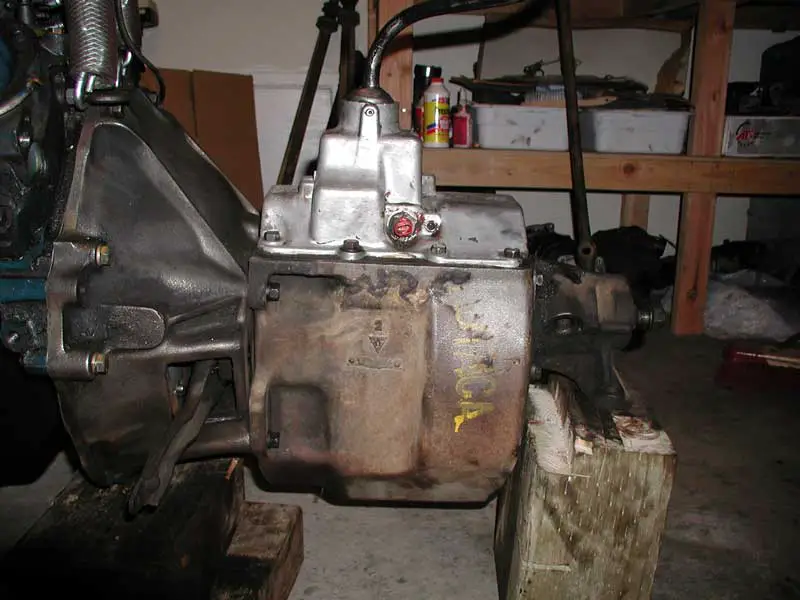

just to give you an idea here is what the NP435 looks like. This pic if from broncoii4x4. he used the 435 and kaufman headers.

kauffman has not been around for years I dont think
My experience is with the Duff long tube and shorty conversion headers (both made by Advance Adapters)
Lots of different 5.0L headers and manifolds have been used, it depends on where you set your engine, your steering column setup, and if you are willing to notch your frame or hack up a brand new header to make it fit.
They are expensive that is true, I bought a set for my Explorer, bot for the fit, finish and performance gains I see it as a worth area to spend some extra $$$

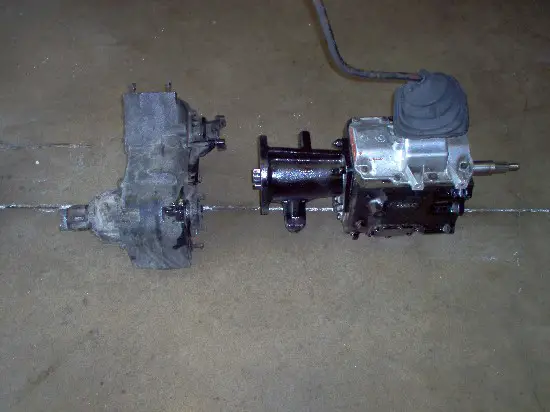

I picked up the Rebuilt NP435 and rebuilt NP205 today. these things are heavy duty. Dont think i'll be worried about breaking these anytime soon.
