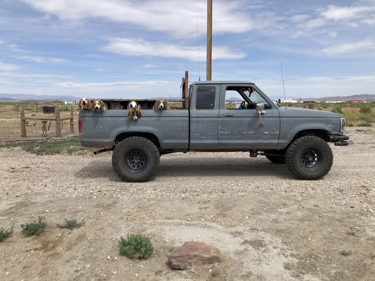

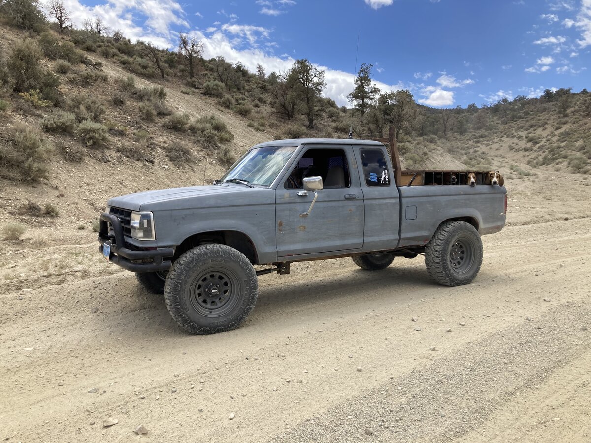

It was a little warm yesterday so I waited until sun down to start working on it. I started beefing up the rear spring packs to handle the weight of my dogs and gear. Took a little longer than I anticipated. Got the passenger side done then started the driver side. Mosquitoes were pretty bad last night and I stopped working on it just before 10:00.
I figured I got around 1-1.5” of lift by adding 2 ranger leafs to the chevy leaf pack. I used the smallest and 2nd to largest leafs from the ranger leaf pack. I may pull the bed sides today and see how much clearance that adds. I cut up the sidewall of my brand new tires on the first trip because they were hitting the rear fenders.
Finished the leafs up. I gained 1” in height unloaded and it only squats about 2” loaded with all 12 of my hounds and 10 extra gallons of gas.

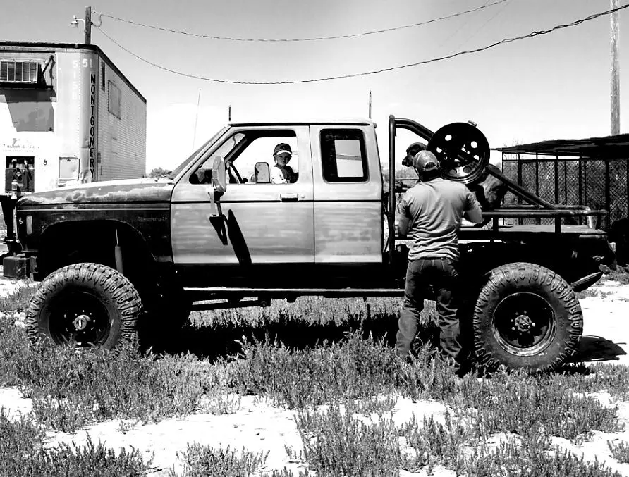

Need some clearance Clarence
Pull those bedsides and a saws all for the front? Flares?
I love the first gen bed with the sides pulled, looks trick. Need to match it up front somehow maybe some glass?
I've seen pictures of a ranger where the guy used a jack in the bed wheel well to flare it out for tire clearance.
Yes that’s called pulled bedsides. There is a simple metal support you cut,
Push them out with a jack and then weld in a patch…. Looks awesome on a gen i
That’s exactly what I plan to do, along with new rear spring hangers and a shackle flip. I’m hoping that gives me a little more lift. I don’t think I’ll splurge on glass fenders though. I did that on my older ranger years ago. It looked great but I tore them up. I’m gonna keep it metal so I can just hammer it back or just leave it. I will be trimming the fronts and maybe adding some lawn n garden flares if it throws rocks and sand.

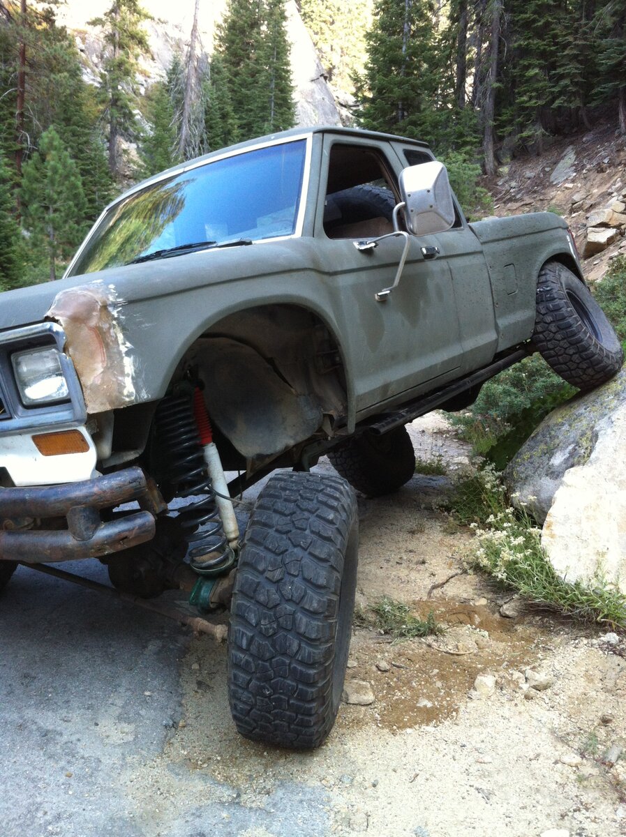

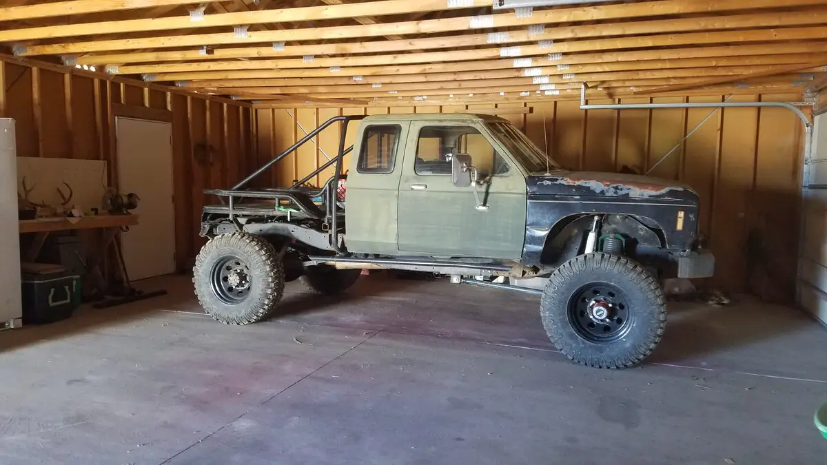

My 87 back when it was 1/2 ton. Kept breaking front axle shafts and blowing up 9” diffs. So now it’s got D-60’s under it.
That thing looks like sex on wheels
Were those fenders original on the truck? I've never seen an 87 with V6 badges
Love the mirrors and the variable rate coils…
Chevy 64’s……..Wicked cool ranger!!
Thanks! I took the mirrors off a 70’s Dodge power wagon. Had to drill the hole in the stock brackets a little bit bigger but they match the truck well and I like the larger mirrors more.
The coils are for an original bronco, I think I got them from wild horses IIRC. They ride good and flex even better. My only issue is that my frame is bent so the passenger coil bulges out pretty bad. I plan to frame swap with a full size Bronco some day. Unless I happen upon a F-150 for dirt cheap.
Hunted a couple days this week. Had a pretty good time. My daughter got to see her first lion and 6 of my pups got to see their first lion. It was a young one so we didn’t harvest it. In hound hunting lingo we call it “Treed and freed”.
The truck is running good but still has a couple bugs.
A surging idle when cruising and put into neutral to coast to a stop.
Leaf packs are still too light.
Radius arms clack a lot in the brackets.
Need to fix the AC.
