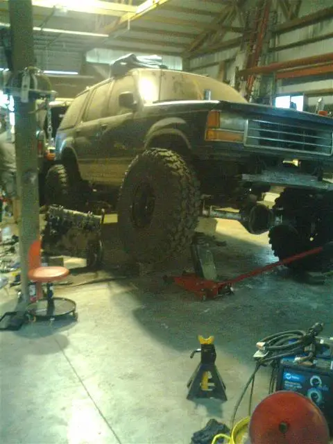

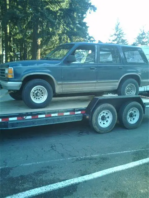

its been awhile since i updated this so here ya go!
i picked this up for $125.00

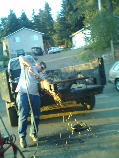

took the body off
my buddy cutting out the ttb crap

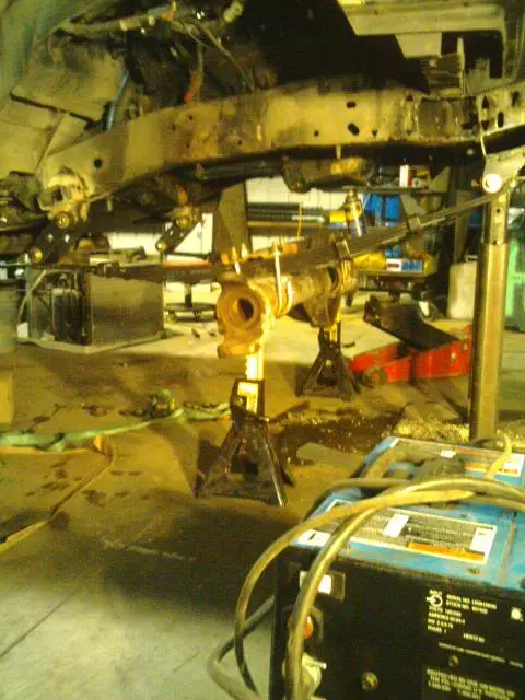

dana 70 installed but not yet centered
motor mounts i built
see a big block will fit into a ford explorer, this is just a test fit i didnt even have the motor mounts built yet at this time

for the rear i did a soa with the stock springs can any one tell me about how much lift that would be? im got a dana 70 rear

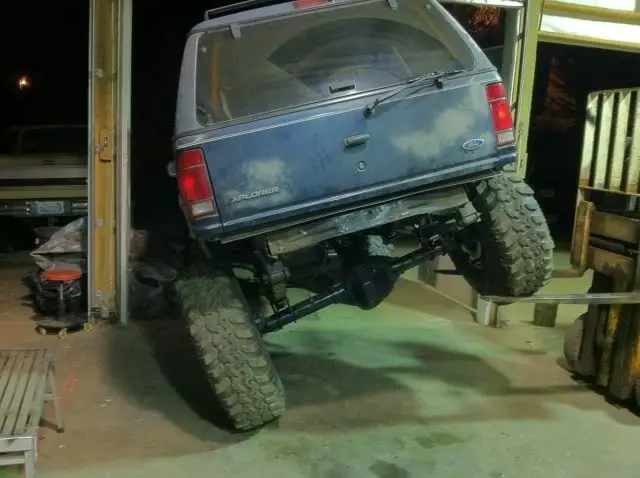

updates
motor mounts installed

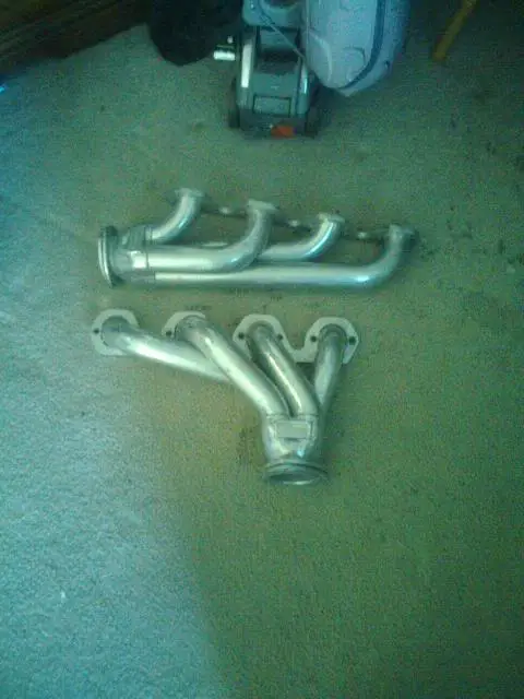

header that im using
got the springs installed

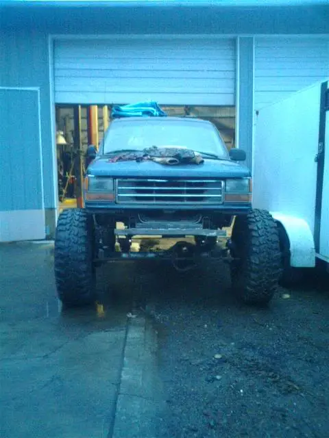

sittin pretty
maxed the jack with a 6x6

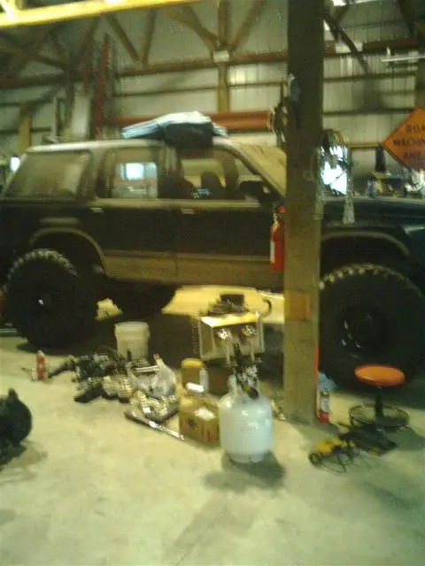

so its been over a year since i pretty much been around, so i thought i would show n tell
so the xplosion sat like this for awhile due to some issue's
life took a turn so i started getting parts

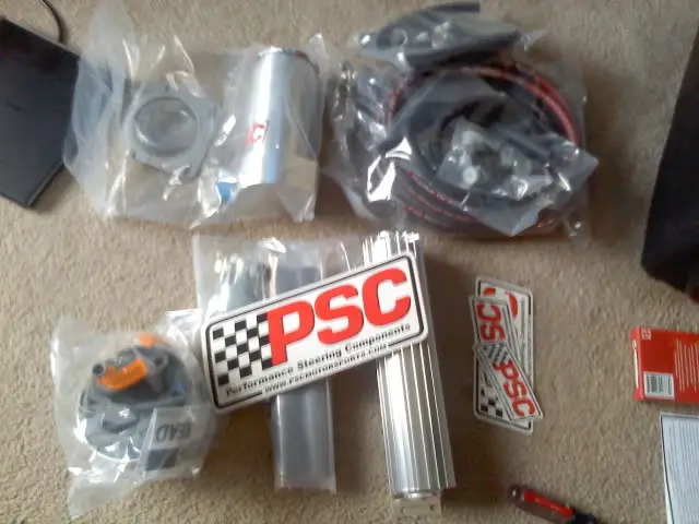

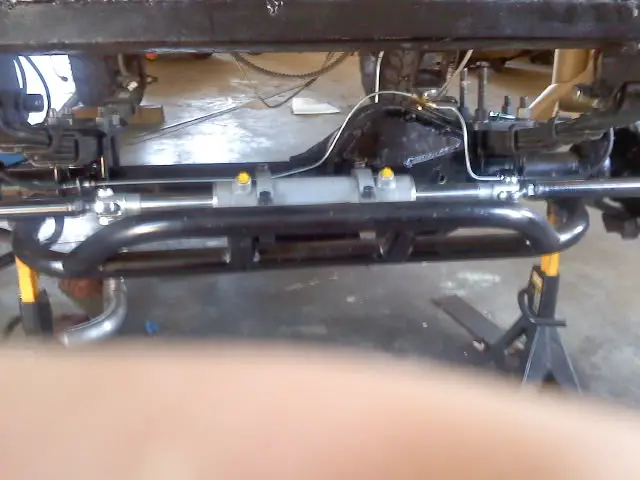

full hydro

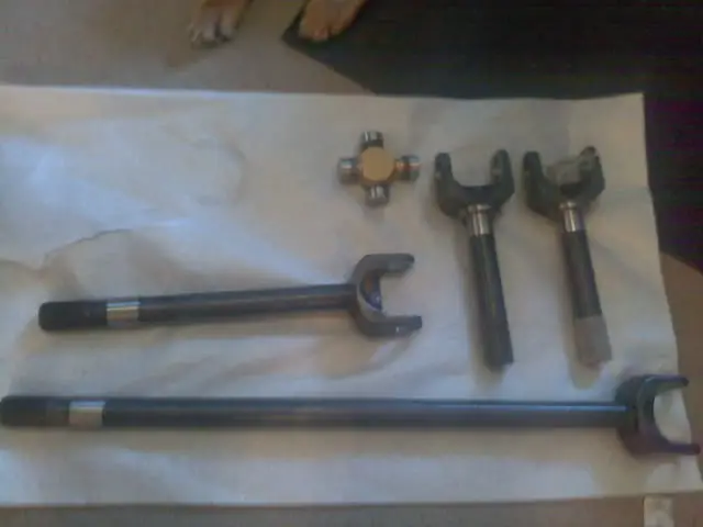

shafts and joints

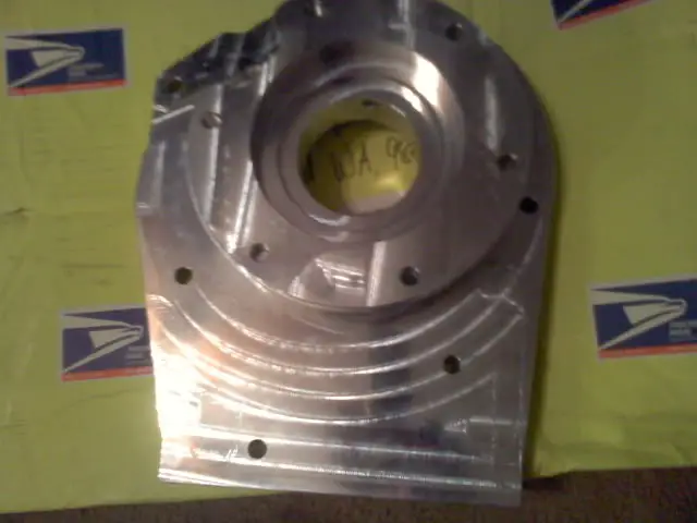

and 203/205 doubler

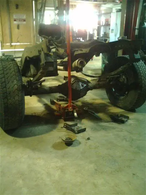

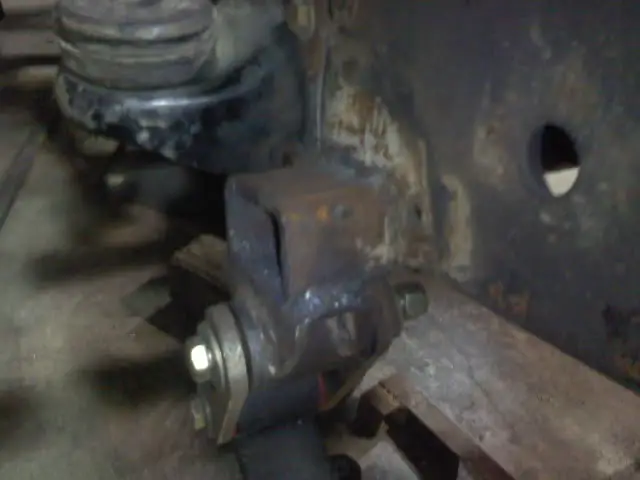

after picking up a detroit for the front i was able to get the gears set up(friends in low places are good to have) and finish putting it together.
forgot i drilled out the front hubs to upgrade from 1/2" wheel studs to 9/16" studs
my buddy added some gussets to the shackle mounts
before
after

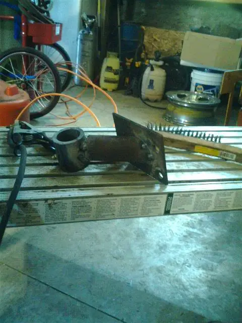

another buddy helped me bend some tube for the ram mount

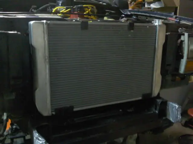

radiator mounted

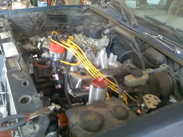

and in this hole is where a BBF lives
only thing i wish is ii had more room. lol. its goodNtight.

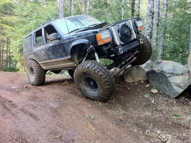

3 times on the trail and in pretty happy with it
a few poser shots

351W is a small block, he said big block, being a 79 id say prolly a 460 or some variant there of, appears to be a Y block motor from what i can see
popeye123
February 9, 2009
18
vancouver,wa
1991/79 1 ton
its a 68' 429
