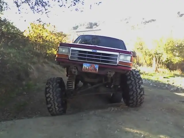

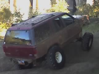

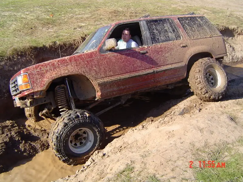

this is my 91 ford explorer on 79 braonco axles. full size dana 44 and 9 inch. i used the cage early bronco coils in the front and the stock leafs in the rear with a shackle. i extended the radius arms 12 inches and added a 1 1/4 hiems at the end. hope ya like. any quesation please ask.

well its a stock explorer draglink with the bronco tie rod. the tires are 35x15.50x15 sx's didnt wanna cut the fenders yet. its a 5 speed with 3.73 gears for now.and yes the rear is spring over with a 4.5 in shackle

actually not as bad as i thought! it struggles a bit to take off from a dead stop but after that it just cruises along the motor runs pretty dang strong! getting fornt and rear detroits and 5.13s next week. doing the 5.13s for some 37 or maybe 38's in a month or two

ya tons of flex! i recommend the cage coils!!! they work awsome. and i think the extende radius arms with the heims help too

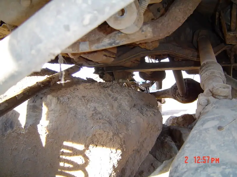

thanks guys i got some new pics!
uh broken radius arm?
