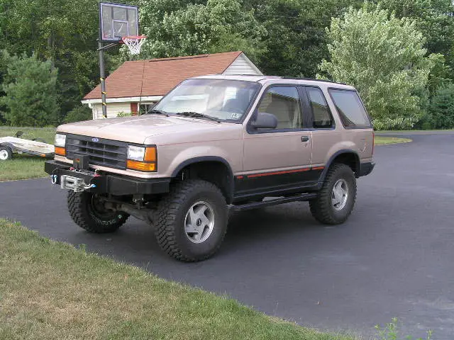

I was one of the fortunate ones that could run 33's with a Superlift 5.5 and no trimming. I also ran 33 x 12.5's on the stock rims.
Why are the brands on the inside?
If you are asking why is it black wall out instead of white..
I can't answer for JDraper, but I can say for myself, I prefer the black out. The white just doesn't stay white, especially on a vehicle taken off-road and personally, I think it makes it look too busy..
It just occurred to me, the Riken tires on our Mustang and the Dunlop tires on the honda don't eve had white raised lettering on them. I can't remember if the Falken tires on the 4x4 van are have white on them.. and I installed them on the rims too.. Dang old age..
I can't answer for JDraper, but I can say for myself, I prefer the black out. The white just doesn't stay white, especially on a vehicle taken off-road and personally, I think it makes it look too busy....
~Mark
What he said :) I preferred it that way.

Ok thanks. I was thinking the person who installed might have made a mistake. Nice notion though.
