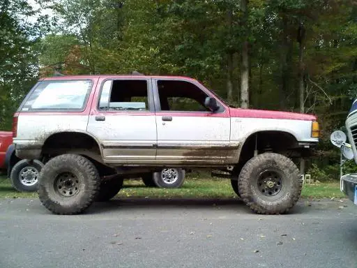

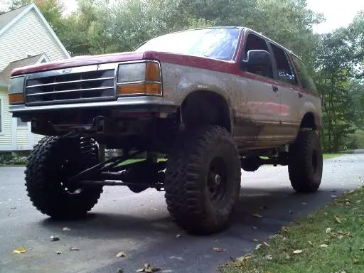

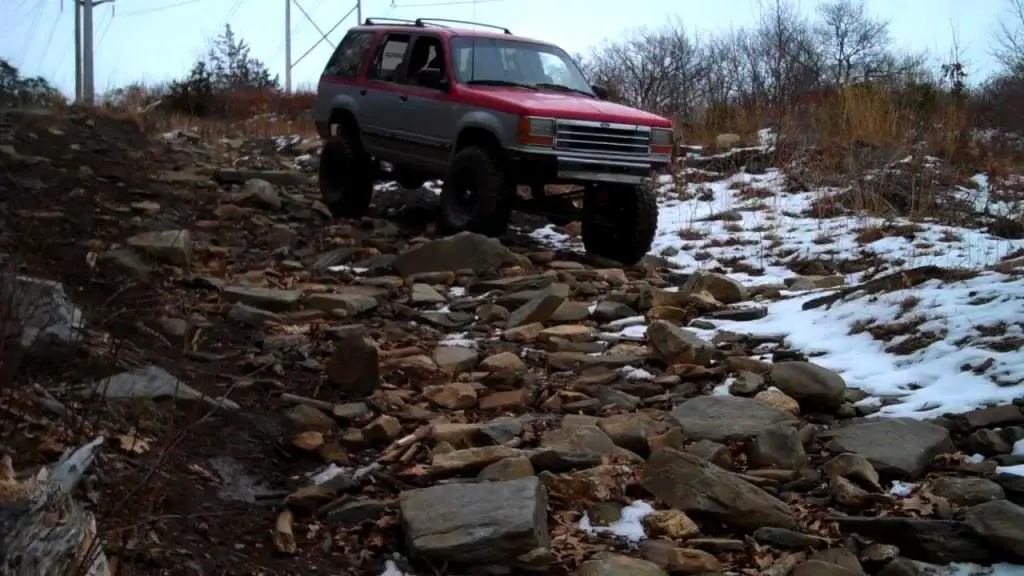

Looks great!!
My only suggestion is to stick with 35s or 36s - because even with 36s, we see quite a bit of D44 axle shafts snapping. So with 37's, you are probably going over the capbility of the D44 axle.

Yea, looks good, Id leave it on 35s they fit great in my opinion.
You will really like it with the 5spd.

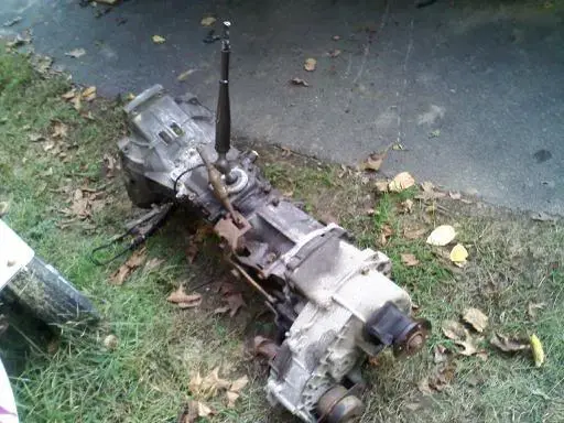

Nice Ex. I would'nt put that 5 speed in if it were me. I do not like how tall the 1st gear is. Maybe with 5.13's it's not that bad with 35's but with 37's you might smoke the clutch. I have had my clutch so hot trying to crawl over rocks it would'nt move anymore, I had to wait for it to cool to get off the trail. Just my .02 cents.

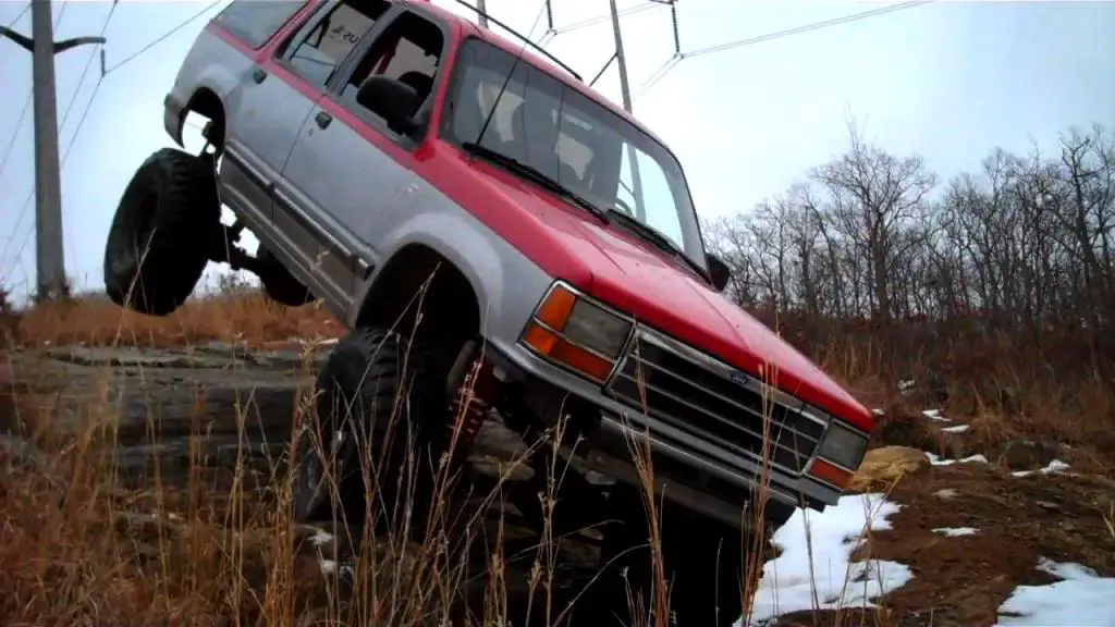

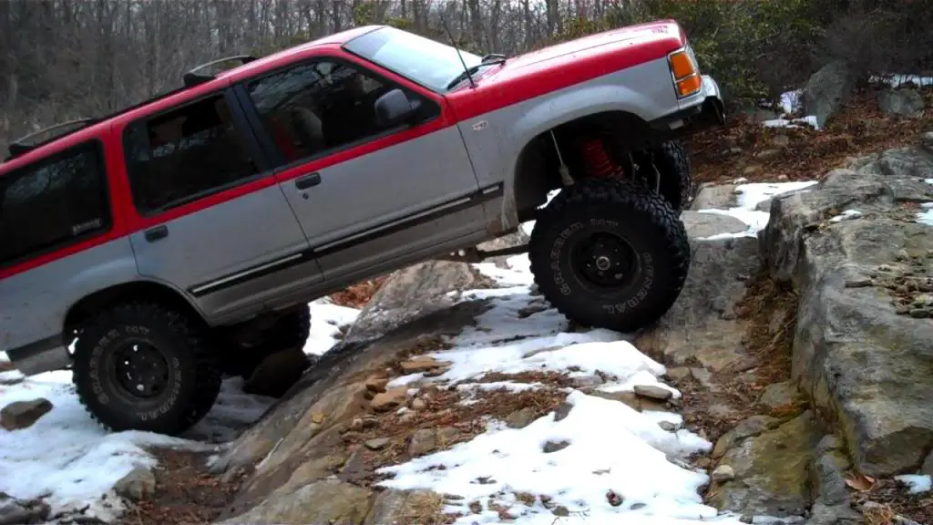

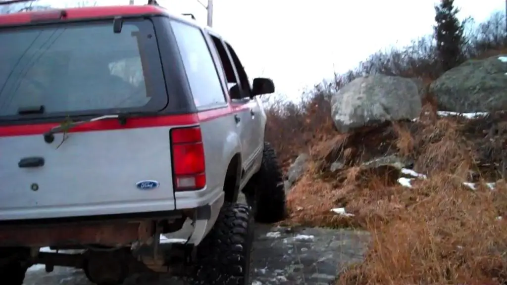

MEANEXPLODER
April 3, 2006
102
HADDAM, CT
91 XLT

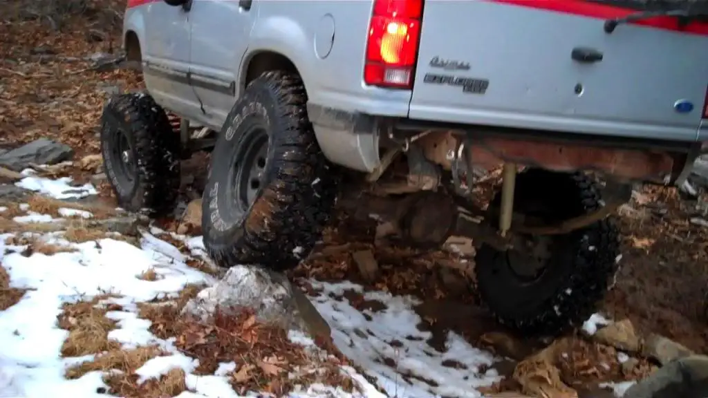

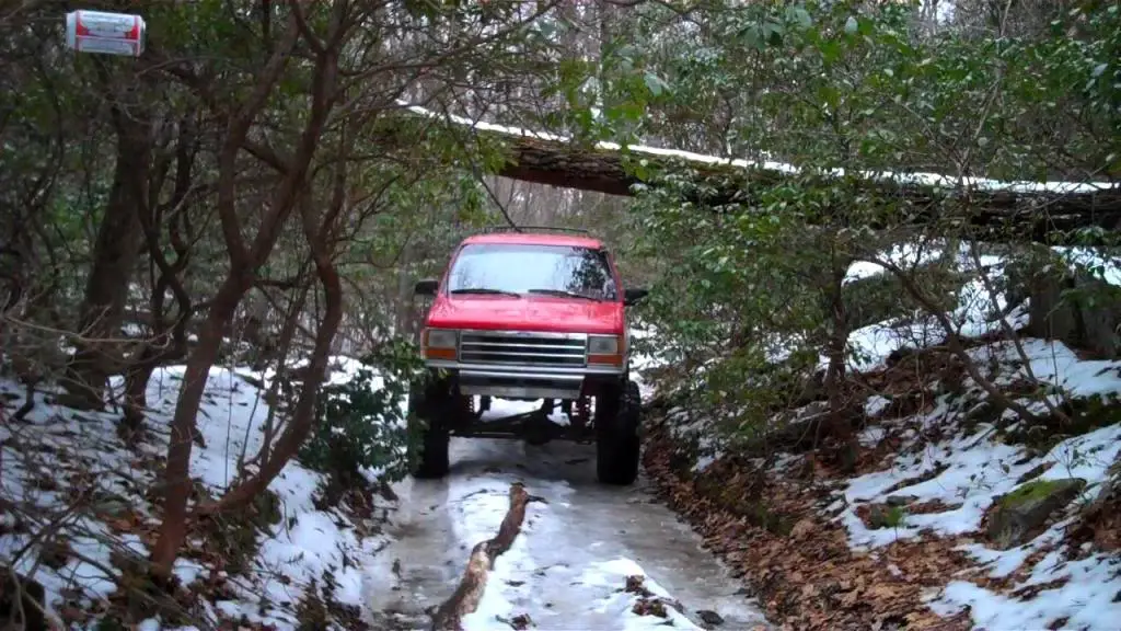

few action shots fartin around by my house
