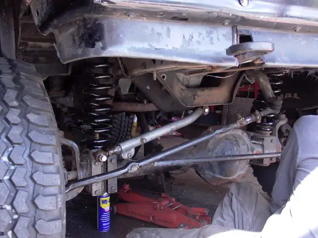

Well she is driving now. I spent 3 days at a friends house and we had a blast.
My junk
its a currie built 9" with YJ outers. Stupid lift 5.5 coils. Rancho 5000 shocks with 15 inches travel. There are 5.13 gears riding on an ARB air locker. Warn manuals (of course) and maintained the 5 on 4.5 bolt pattern. Long radius arms (will be heim jointed soon) and all custom steering.
We literaly finished this project just a few hours ago. There is a few small things left to do but I drove it the 2 hours home tonight and It drove FAR better than it did with the TTB, and ZERO bump steer, I mean NONE. You will see why when you see the pics.
I must thank my friend for all his help and his and his wife's hospitality. The trip was great and he worked hard as hell the whole time. We probably each put 20 hours into the job, not too bad. There is no feeling better than looking at your old TTB sitting on the ground waiting to get drug away :)
I plan to get softer coils soon also as the stupid lift coils are known for being too stiff. one of many things that will happen soon. I still havent re geared the rear to match yet so no 4x yet nor any inaguration pics. However lets get to some pics of the job.

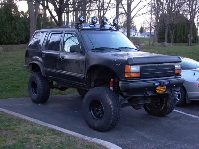

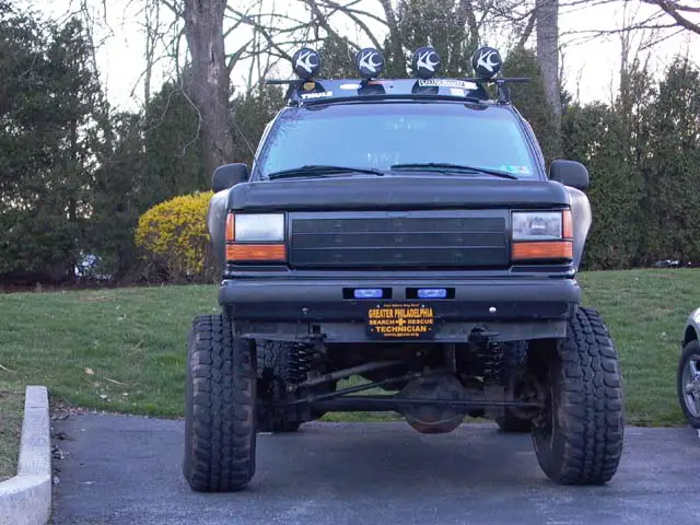

Oh those dinlky looking tires under there are 35's. the perrys fenders fit like crap but make TONS of space. I dont have any great completed photos yet but they are on the way. In the pics the SOA was not yet done. Now it is and the front site slightly higher than the rear. I am hoping that it setels to being even as the leafs are worn and the coils are brand new. If not I will add a small block in the rear perhaps.

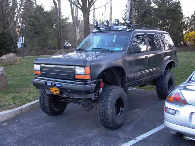

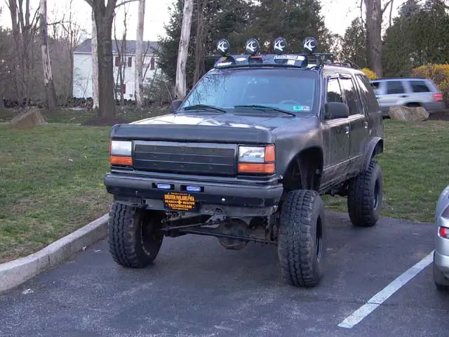

Took a couple real quick shots today in the parking lot. I should be regearing the rear to match the 5.13 front on monday. Then action pics soon I hope.

one more.

DAM MAN, i have have SOA, and a 5.5 superlift, and your is way taller than mine,

He did an SAS thats why.

looks like you need an alignment non the less it looks sick. why did you go with the 9" and not a 44? i cant tell from the picks but did you use radius arm buckets or hemis.

Yeah I need an alignment, though the toe looks way out in the pics it isnt bad at all. Just need the time to put it on the rack. Right now there are radius arm brackets ala modified stupidlift. This will change to heims ASAP. I went with the 9 inch for several reasons. first it is way tougher than a 44. second this is from currie and you flat out cant beat their engineering. Third, imagine if you will both your axles using the same 3rd member. Ahh think about being able to swap stuff like that around :) I actualy had a 44 in the garage for a while but when I got this I gave it to a former member of this site.
