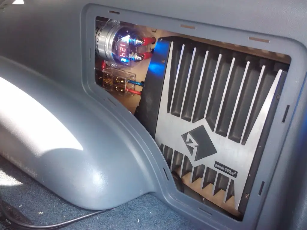

This is what I added to my sport. I cut in a larger hole to accomodate an 8" sub. It worked well but I like my new set up more.

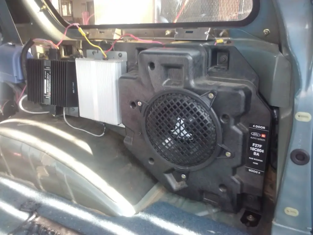

Yes the sub signal is generated form the first amp. If your not getting a signal check that the sub isn't blown. If you look up at the picture that I posted you can see the yellow wire is the positive and the red is the neg, grounded to chassis. The other plug into the silver amp is the signal in, and the remote turn on. There is a post on here some where that has the schematics for all the systems. I don't remember what the link was and I'm in a hurry right now.

That amp only produces 45 watts x 1 @ 4ohms. And the 4ch amp is also 45w x 4 @ 4ohms. Tho it is crossed over to something like 145hz I think. Not an extreamly powerful setup but with the right components it can sound pretty good. You can add a quality head unit, run only the high outputs. And replace the speakers with quality 4x6's and it will make your ears ring. But thats about the capacity of the wiring that comes in the rig.
